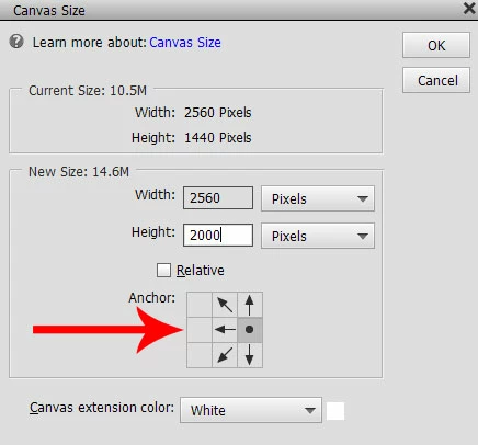

    99jon
    February 27, 2020
    Use the menu:
    Image >> Resize >> Canvas Size
    For example the dialog below shows an image size of 2560 x 1440
    If I wish to adjust the height to 2000 without affecting the width I would type the desired dimension into the height box and click off the horizontal pointers. The resizing is then only applied to the height. You can only do this on individual images.
