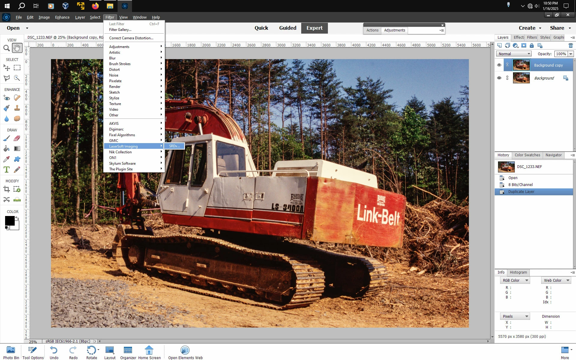

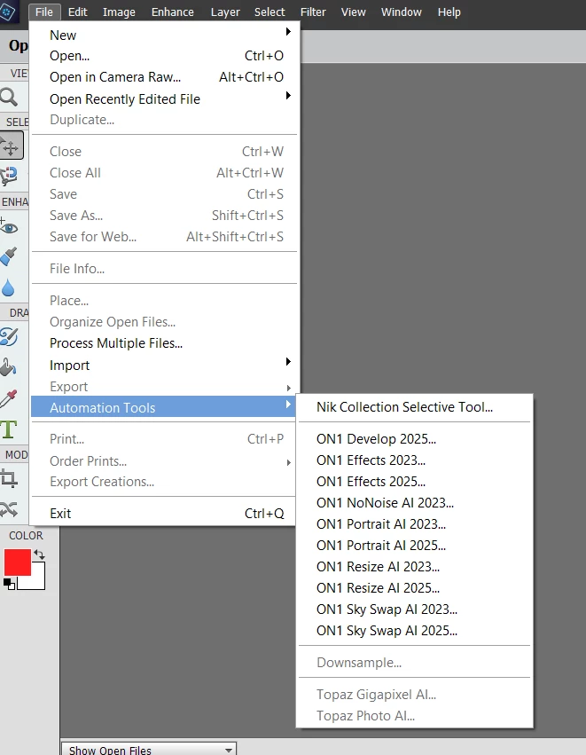

. . .  After looking at my last screenshot, I see that I apparently had a downloaded a trial copy of the SDRx plug-in.  I checked my Elements 2019 installation and the trial version is available to me:

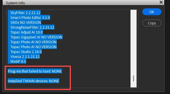

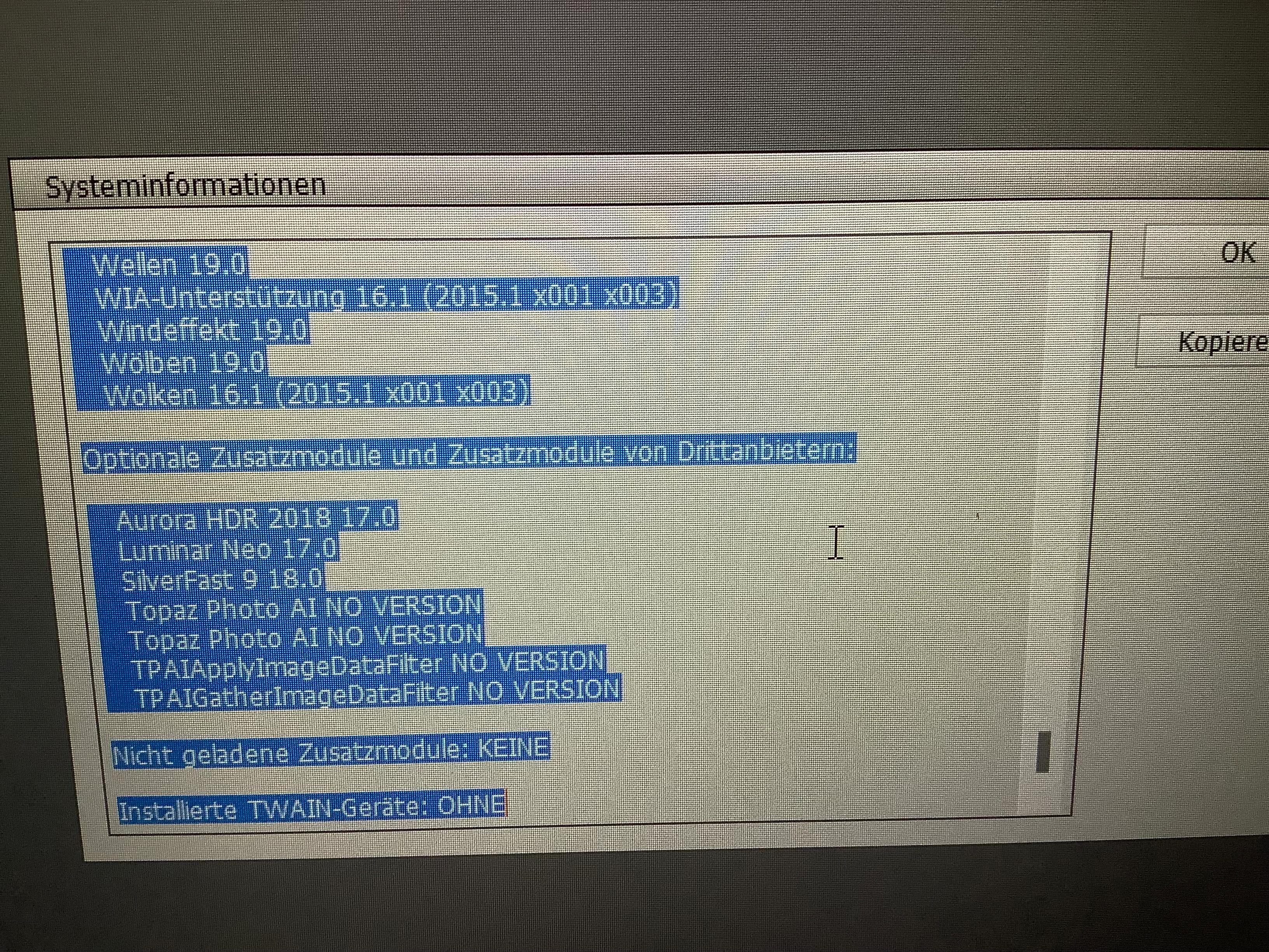

If you go to Help>System Info . .  and scroll to the bottom of the information, does the plug-in appear under Plug-ins that failed to load?
Jan 17, 2025 8:56 AM UTC
Siehe Foto

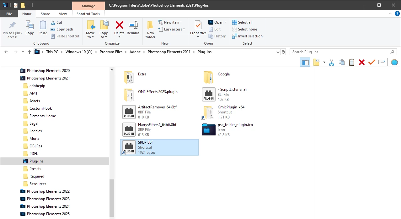

Did you install the SDRx Plugin on the D drive as well?
If you either installed the SDRx Plugin on C or D drive you could create an Alias (shortcut) of the
SRDx.8bf in C:\Program Files\LaserSoft Imaging\Photoshop SRDx Plug-in
and put the Alias in your PSE 2021 plugins folder
D:\Program Files\Adobe\Photoshop Elements 2021\Plug-Ins

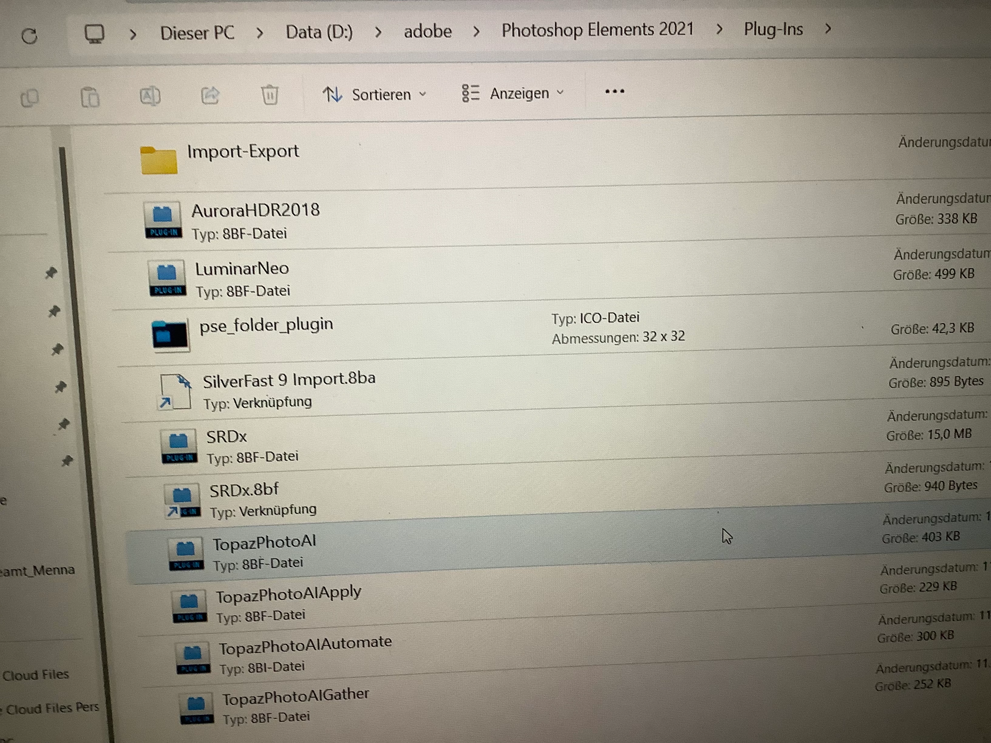

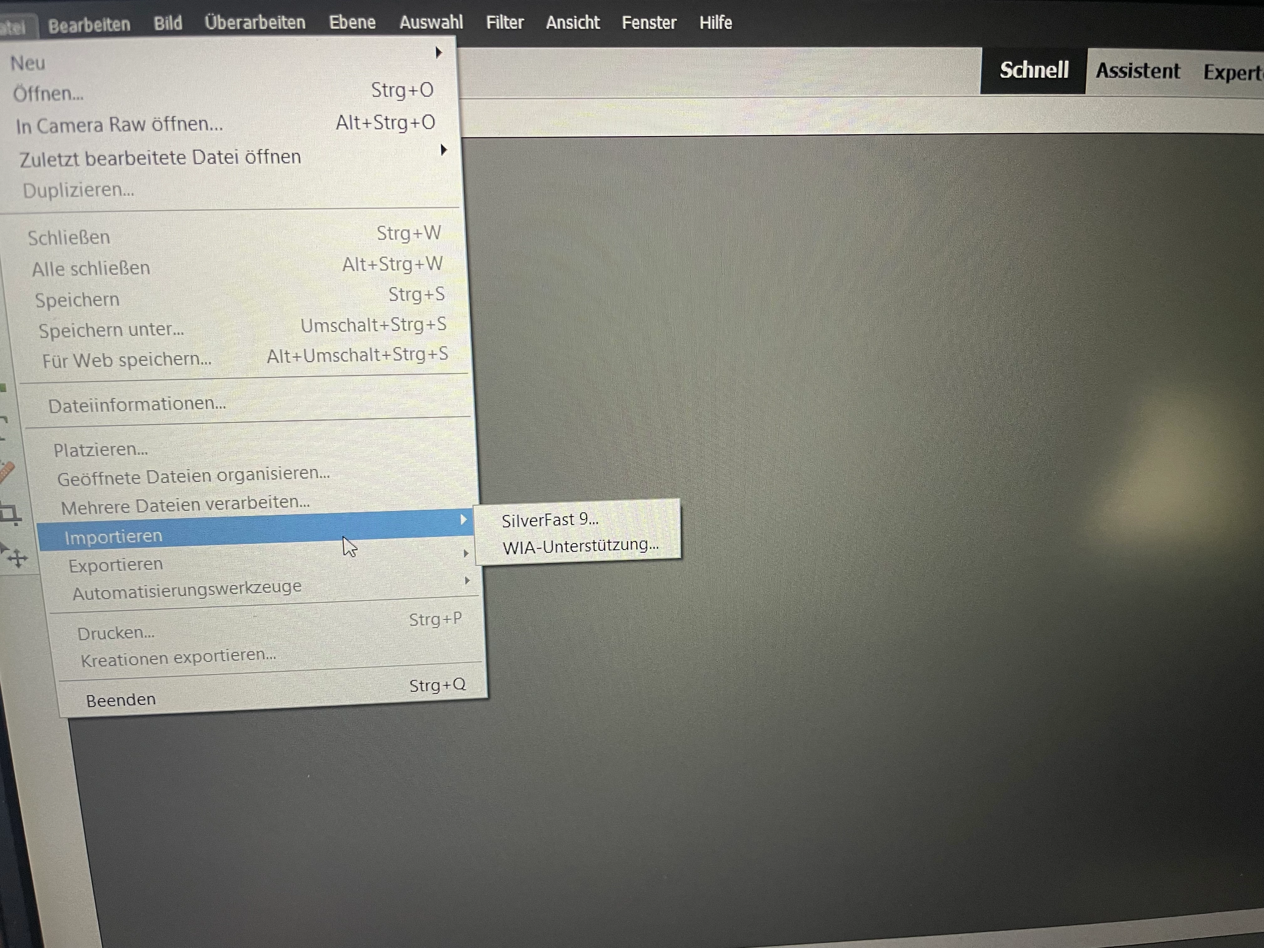

Jan 17, 2025 8:01 AM UTC
Danke für die Hilfe. Bei der Installation von SRDx wurde automatisch auf 😧 eine Verknüpfung erstellt- siehe Foto.
Es funktioniert trotzdem nicht.
