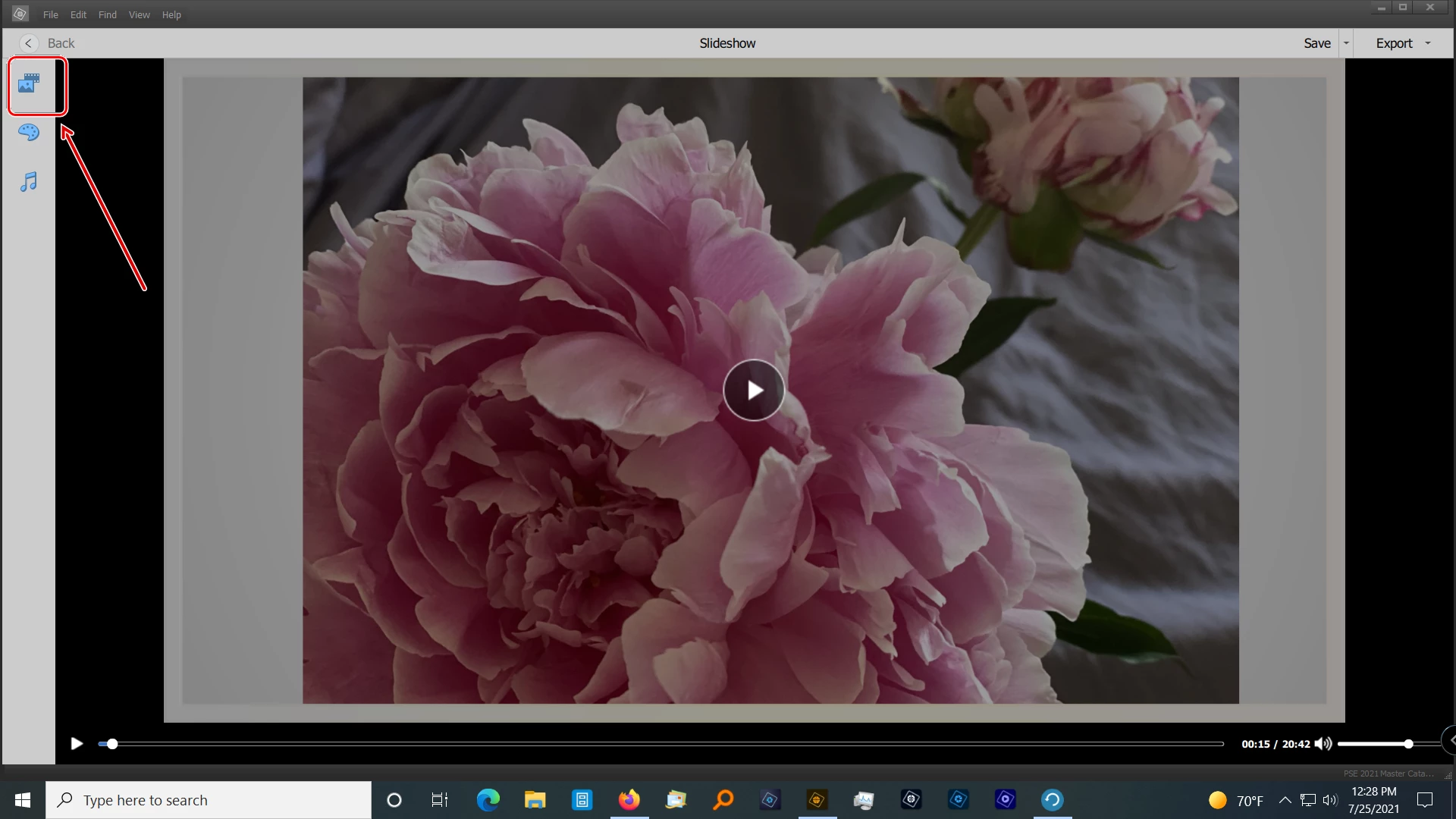

@Shelley5FB2 said:
only the theme and music button will show up on the left side
Are you saying that you do not see the Add Media button shown in my screenshot?
What is the size and resolution of your monitor?  The program requires a minimum of 1200x800 pixels at 100% scale factor.
Please give us a screenshot of what you are seeing.

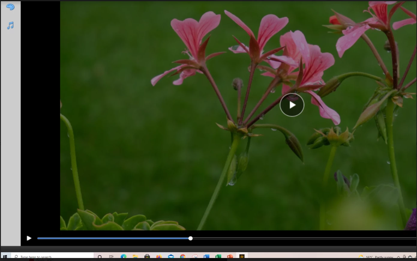

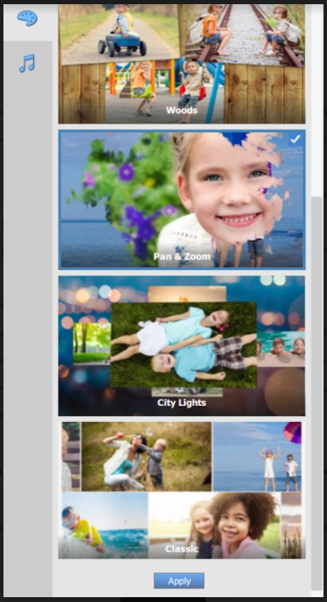

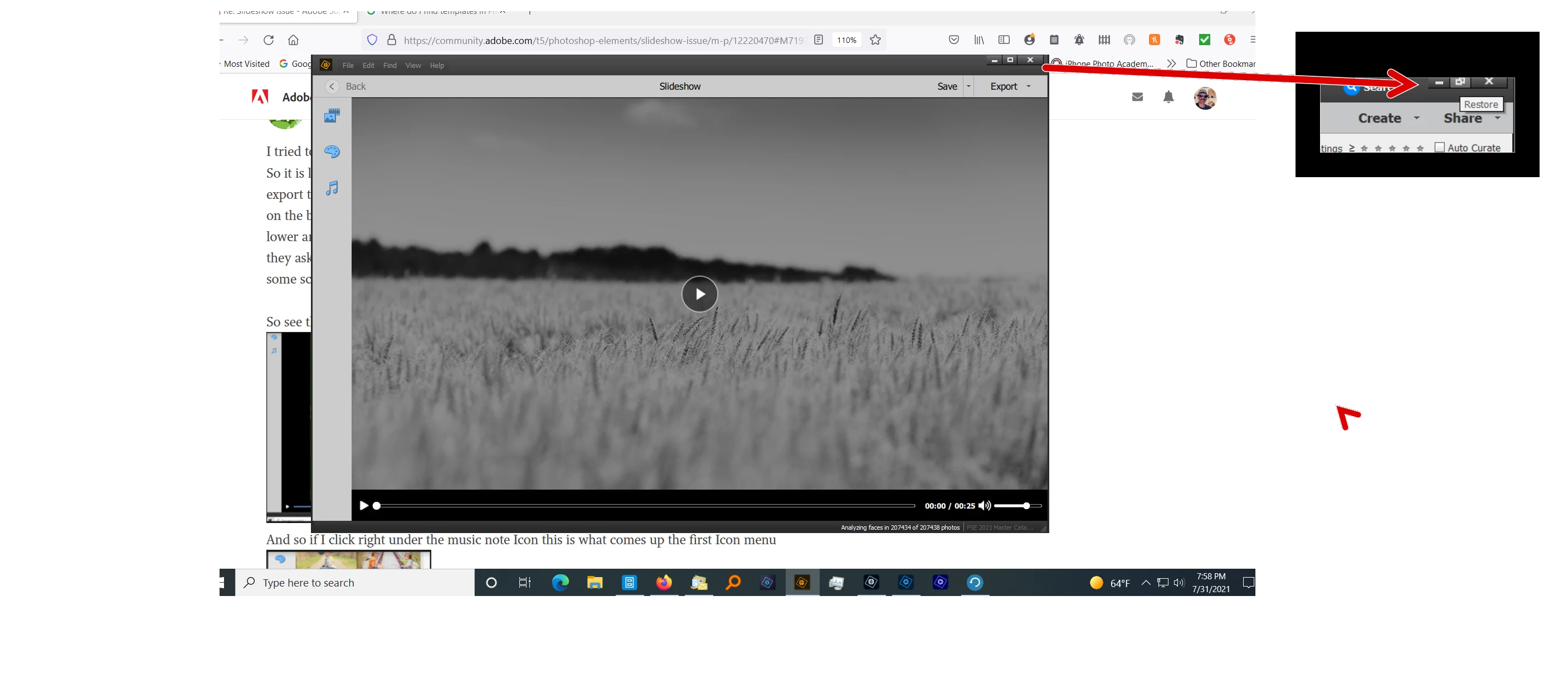

So it is like the whole screen is off kilter - you can only see two of the icons on the left and no save or export top right - and if you click on the icon nothing happens you litterally have to click below the icons on the blank portion, if you click right under the two Icons I do see first menu will come up go a little lower and second menu comes up a little lower and third menu comes up.  I did get an email from Adobe they asked if I tried to uninstall and install - I have not yet but will try that in next day or so.  Here are some screen shots
So see this is what I see - I did not cut off the snip I do not see the top icon or the ones on the left
And so if I click right under the music note Icon this is what comes up the first Icon menu
Shelley

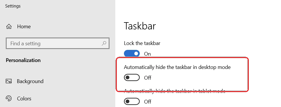

Shelley, do you possibly have your Windows Taskbar set to Automatically hide?  If so, right-click on the Taskbar and choose Taskbar Settings.  In the dialog that appears, toggle the setting off.
July 25, 2021
Hello
