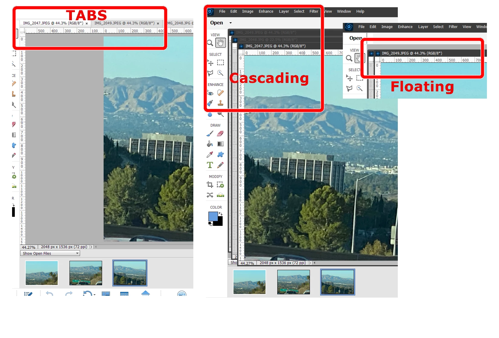

    When I open multiple files, they sit one atop the other on the desktop, and i use the windows drop-down menu to foreground one or another.
    I'm not sure what you mean by this.  Are the photos available in Tabs?  Or are they cascading or floating on top of each other?

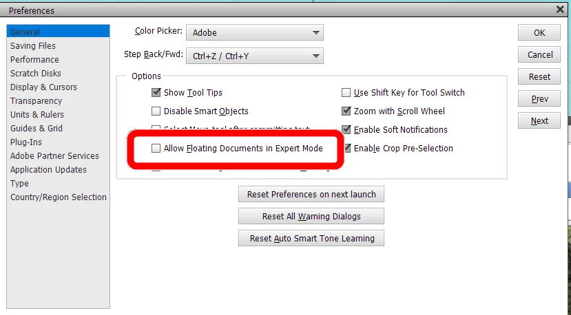

    And in the Edit>Preferences dialog, do you have the allow floating windows box checked or unchecked? How the windows behave depends on this choice.
    broscosmoline
    Mar 25, 2024 7:08 PM UTC
    Thanks Greg - it turns out the display option i was looking for  - which is the default for multiple files - was Tabs, and of course i found i could select that mode via Window>Images>Consolidate To All Tabs.   Thanks for your help!

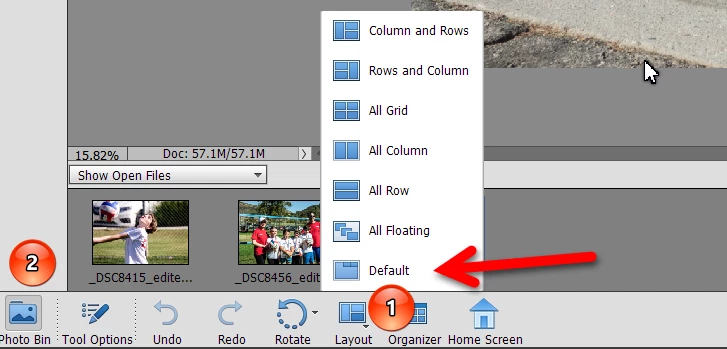

    I am not entirely clear about your questions and you haven't said what version of Elements you are using.  But if you have a recent version, click on the Layout button (1) and select Default.  The Photo Bin should reappear if you click on the button (2).
