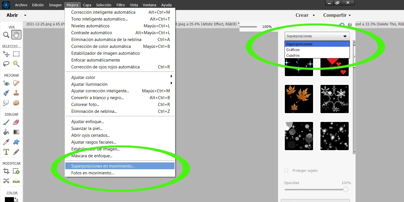

Hola, buenas noches.
Como puedo modificar las superposiciones que vienen predeterminadas?
O bien, como puedo crear mis propias superposiciones y agregarlas al menu..
Gracias y saludos.

As far as I know, there is no way to modify the overlays or add your own overlays to the menu.

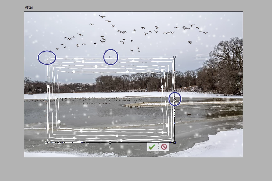

It is only possible to change the size of the Frame or Graphics overlays by adjusting the handles on the edges of the frame or graphic.

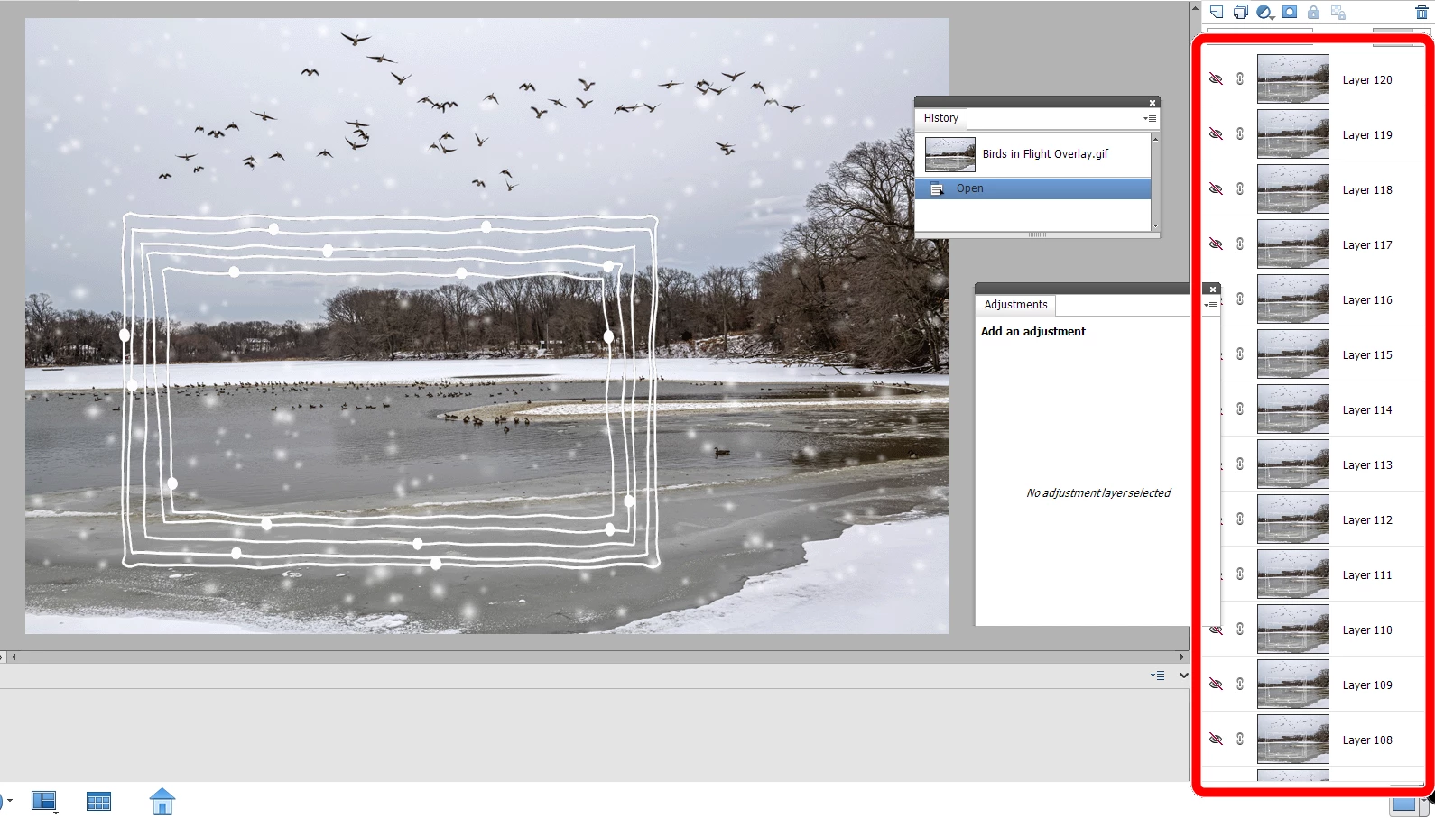

And I suppose you could make some adjustments to the overlays by exporting the file to a .gif and opening the .gif.  However, you would then have a file containing more than a hundred layers and would need a lot of patience and creativity to make any adjustments.
Of course, you can purchase or create your own overlays in Expert mode and Save to Web as an animated gif.  But I don't think that is what you have in mind.

No sabia que al abrir un gif podia trabajar con cada una de las capas. Tienes razon, para hacer algo asi se necesita mucha paciencia y mucho tiempo. Pero ese consejo me va a servir para desarrollar otras ideas.
