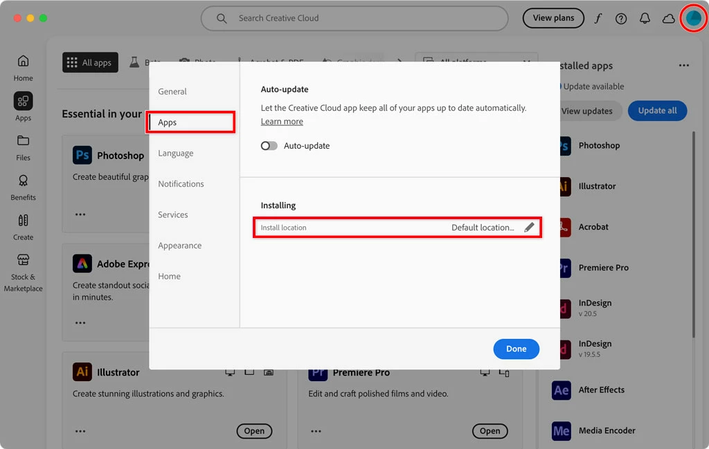

If you really do want Photoshop to be on a non-C drive, you can do that, but only by reinstalling. For example, on my Mac, the Adobe Creative Cloud installer provides an option for which volume I want to install on, as shown in the picture below. I assume this option is also available in Windows. If you wanted to try it, you should use the Creative Cloud desktop app to first uninstall Photoshop, change the installation location setting, and then reinstall Photoshop and it should go there. Repeat for all Adobe apps on your computer.

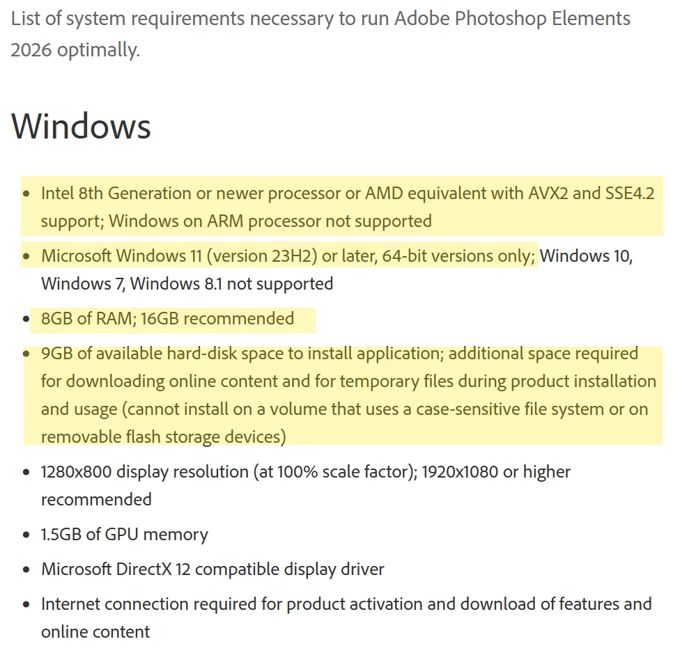

Oct 25, 2025 10:21 PM UTC
Thank you so much, Conrad and everyone else!  We really appreciate your detailed, informative, helpful replies.  We ended up purchasing a new tower with 2TB on C drive plus updated PhotoShop Elements to 2026.   My husband is still getting everything set up but your replies helped us understand the issues and address them appropriately.  Thank you!
Nancy OShea
Oct 26, 2025 12:46 AM UTC
For future reference, the basic system requirements for PS Elements 2026.
https://helpx.adobe.com/photoshop-elements/system-requirements.html
