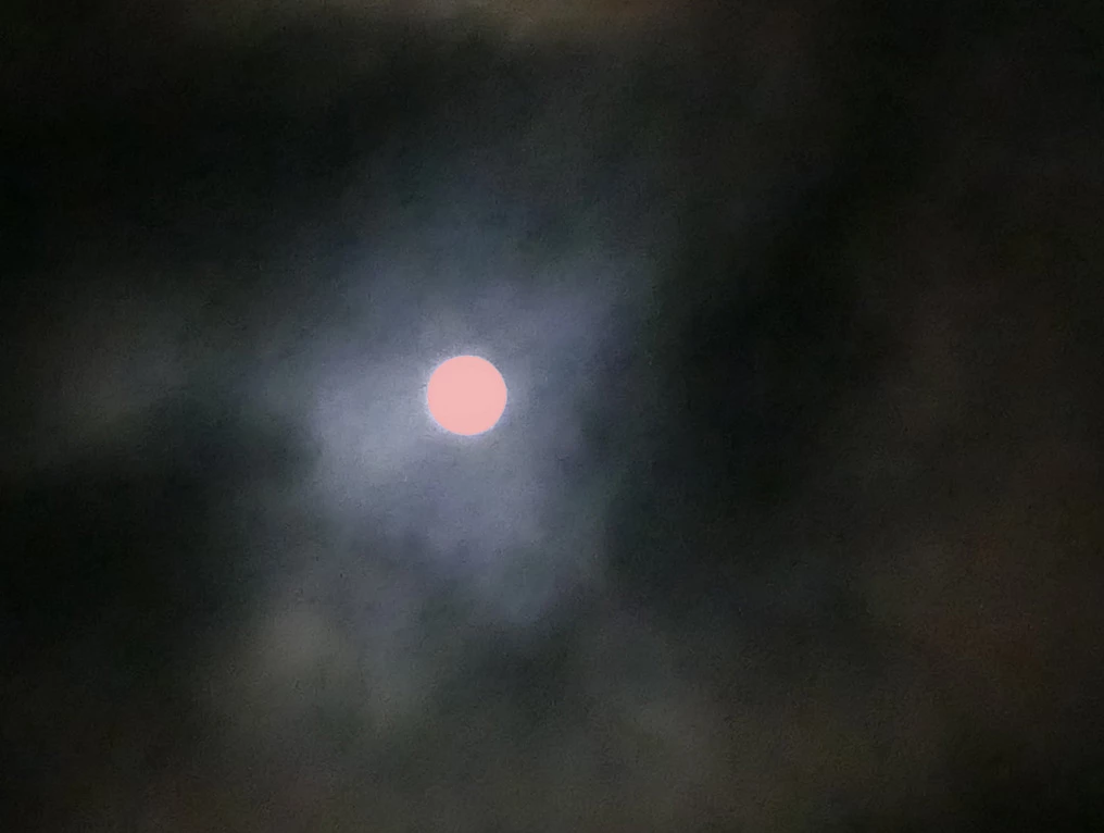

I'm trying to change the color of a round object. Eventually I want to learn how to copy the color from another photo, but to begin with, I just want to manually adjust the color. I used the Quick Selection tool to select the object. I'm using PSE 18, but used the following instructions from the "The Photoshop Elements 15 Book for Digital Photographers"; it seems simple:
Now let’s make an adjustment and you’ll see that your adjustment will only affect your selected area. Click on the Create New Adjustment Layer icon at the top of the Layers palette, and choose Hue/Saturation from the pop-up menu. In the Hue/Saturation adjustments palette, drag the Hue slider to the left to change the color of the tiles to a green color. Notice how just the color of the tiles is changing and nothing else in the image? This is why selections are so important—they are how you tell Elements you only want to adjust a specific area.
But when I do that, the color of the object doesn't change. I can see that an extremely tiny area on or outside the edge of the selection is changing color, but nothing else. As an experiment, I used the rectangular selection tool to select the object and surrounding pixels. In that case, the area outside the object change color when I moved the Hue slider. So has something changed from PSE 15 to PSE 18, or did the author omit a step?

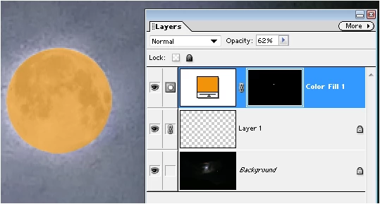

You can always cheat and download an orange moon from the internet (Google Image search yields hundreds).
Put it on a new layer, and resize/reposition to cover the old moon.
You can also download a grayscale moon and color it as you wish while still revealing the craters.
In this example I downloaded the grayscale moon, added a Solid Color fill layer of orange, and lowered the layer's Opacity to reveal the craters.

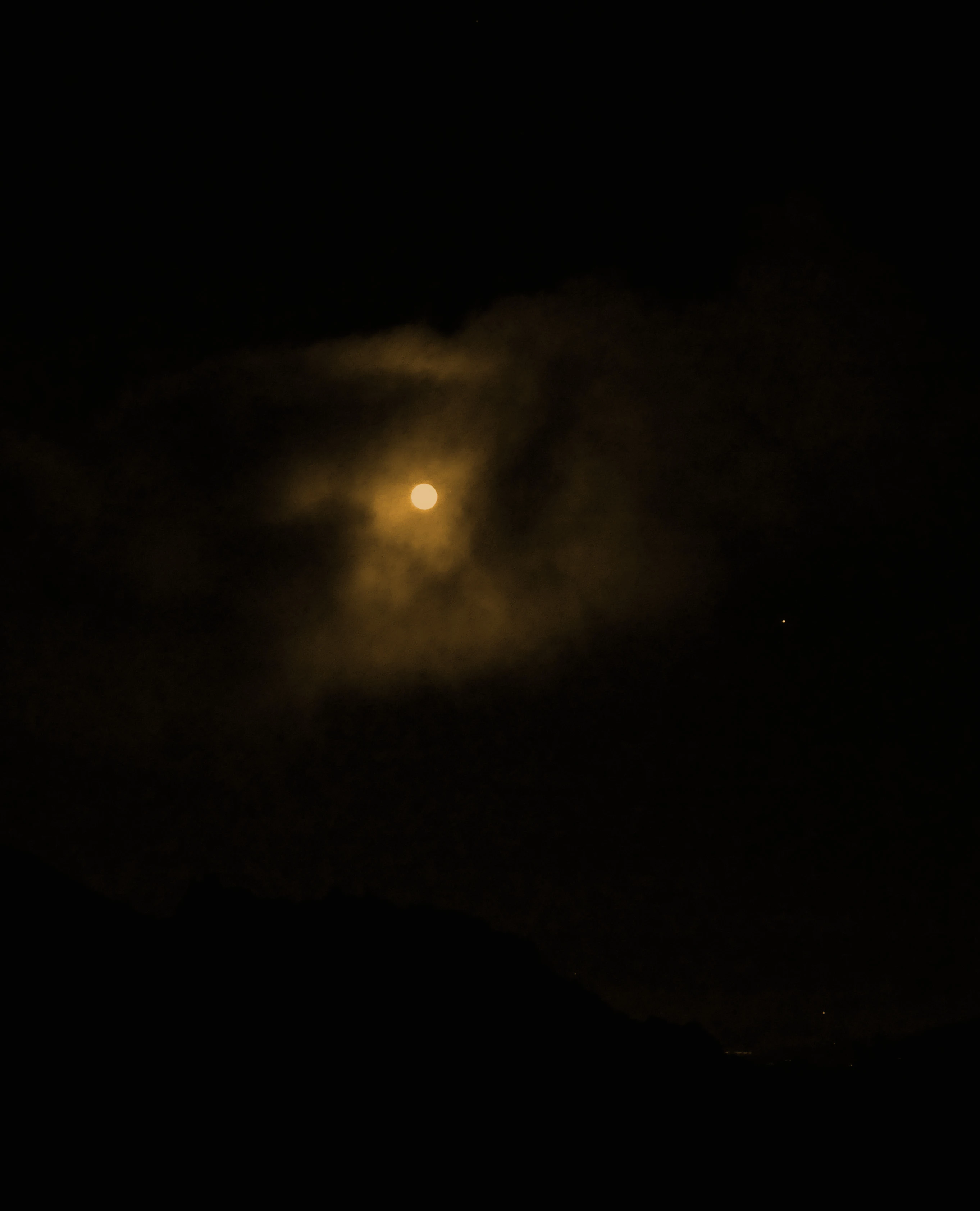

I'm already cheating! I appreciate all the help. With Mark's method, I was able to just color the moon, as I set out to do. (And yes, it looks very fake.) With Hatstead's method, this time adjusting the Lightness slider, the entire photo was affected by the change in Hue, not just the moon. Although that wasn't what I was trying to do, I love the result:
My next project will be to learn how to adjust the moon by grafting on the color from another photo I took of the moon, in which the camera captured the orange color. But first I have three sets of photos to process. Thanks again.

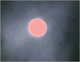

If the periphery of the entire moon is not selected the end result might be a tiny glow remaining from the glow around the moon, as in mine and hatstead's examples:
If this happens, you can apply a Free Transform to the moon layer and enlarge the moon a bit.
Here I increased the size to 105% on the Free Transform options bar:

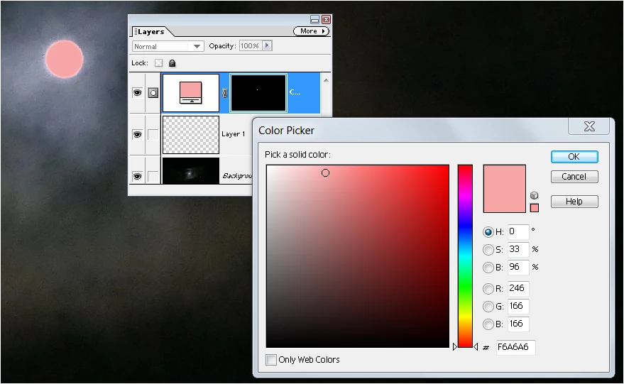

Anyway, here is another method:
Ctrl-click the moon layer to select the moon.
Add a Solid Color adjustment layer and choose orange in the Color Picker.
If you later want to tweak the orange (make darker or lighter), double-click the adjustment layer to bring up the Color Picker again.
