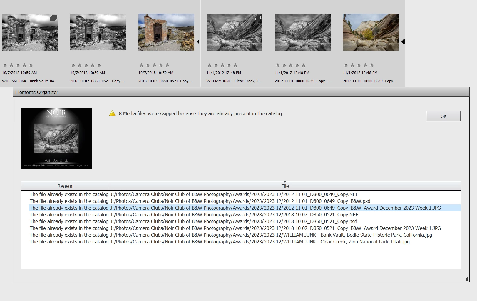

I have imported two .jpg files into the Elements 2022 Organizer, but their thumbnails will not display in the folder where the files reside.  I have verified using the Windows 11 File Explorer that the file names are unique.  When trying the import a second time the Organizer says that 8 files were skipped because they are already in the Catalog, but the Organizer still will only displays thumbnails for 6 files.  The 6 files that it shows are the ones at the top of the attached clip.  One of the files that will not display is the one shown in Elements Organizer message box.  Its associated message is highlighted in blue in the list of files skipped.  The other file that won't display is the other file whose file name ends in "...Week 1.jpg".  Both of the files that will not display in the Elements Organizer will display in Adobe Bridge.  I have run the catalog error detection tool which indicated that no errors were found and I also did a catalog repair even though no errors were found.  I've powered down and rebooted my Windows 11 system and tried again.  So far I've found nothing that will make the two thumbnails appear, but just now I was able to import 8 other .jpg files from another folder and have their thumbnails displayed.  Is there a way to "manually" delete the catalog entry for these two files and try to import them again?  Any ideas will be greatly appreciated.

I tried your last suggestion which was one I had not though of, thanks.  I first opened up the Organizer after my system had been powered off for the night and freshly booted.  I then clicked on the folder where the "missing files" are located and expanded the stacks to see the 6 files whose thumbnails are visible. The 2 "missing" files did not have their thumbnails displayed. Next I right clicked the folder name in the My Folders list.  From the available options I selected "Import Media."  The screen shot after the Import is attached.  What the Organizer reported is hard to explain.  It said that 4 media files were skipped (out of the 8 media files in the folder) because they were already in the Catalog.  The 4 that it reported skipping were the .NEF and .psd files.  It did not report skipping the .jpg files even though two of them are already in the Catalog and being displayed.  The two .jpg files files already in the catalog are the top files in the stack and appear as the left most thumbnail in the attached screen shot.  The other 2 .jpg files are the ones that won't display. After clicking the "OK" button only the 6 files are displayed, the same ones that were shown before the attempted import.

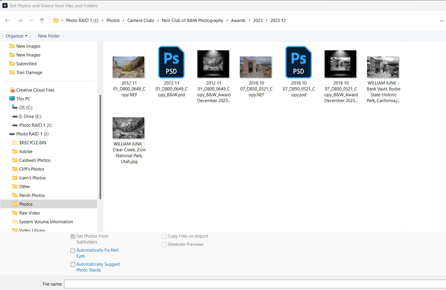

Thanks for the assistance.  I just did the shift-ctrl-K file search for each of the two files that don't display the thumbnails.  They were both found, one instance each, in only the folder where they are supposted to be located.  The search does display the thumbnail for the file.  I Then tried deleting each of the files from the Catalog, leaving the actual file in the folder.  I then did the File > Get.... operation by selecting each of the thumbnail images from the two files I just removed from the Catalog.  The File > Get... operation was reported as a successful addition to the Catalog.  When I then went to view that folder, the two files just added to the Catalog did not display.  Is it possible that there's an undocumented limit on the length of a file name that can be added to the Catalog?  These two file names are longer than any of the other file names in the folder, but I serious doubt they are longer than all the other file names in the collection.  The attached .jpg shows the folder view from the Organizer during the File > Get... operation.  The two images that I was adding to the Organizer are the ones with the large black border.  They are .jpg file types.  Note that the folder contains 8 image files.  I specifically selected the two files, rather than doing the File > Get... on the entire folder.  Don't really know what else to try.

It is possible that I may have caused some confusion by referring to "Importing" files.  What I am actuall doing is using File > Get Photos and Videos > From Files and Folders...  I've save the two files to the desired folder from an e-mail sent to me, then tried to use the command just mentioned to add these files and their thumbnails to the Catalog.  I've been doing this for years and never had a problem unless for some reason I duplicate a file name.  In this case the messages displayed in the information box suggest that there actually 8 files registered in the Catalog and they are in the folder where I expected them to be. Thanks for the suggestions, but I'm thinking the problem may be somewhat more complex in nature.
