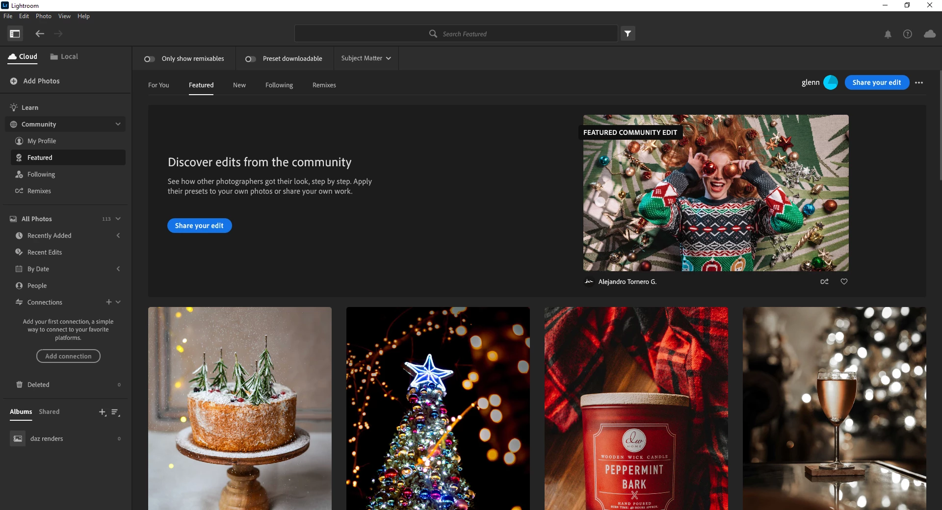

The full version of lightroom is pretty nice (I subscribe to Photoshop for only $10.85 a month)....  the current version is 8.1
This link includes a good discussion comparing versions.
https://www.dpreview.com/forums/thread/4761916
