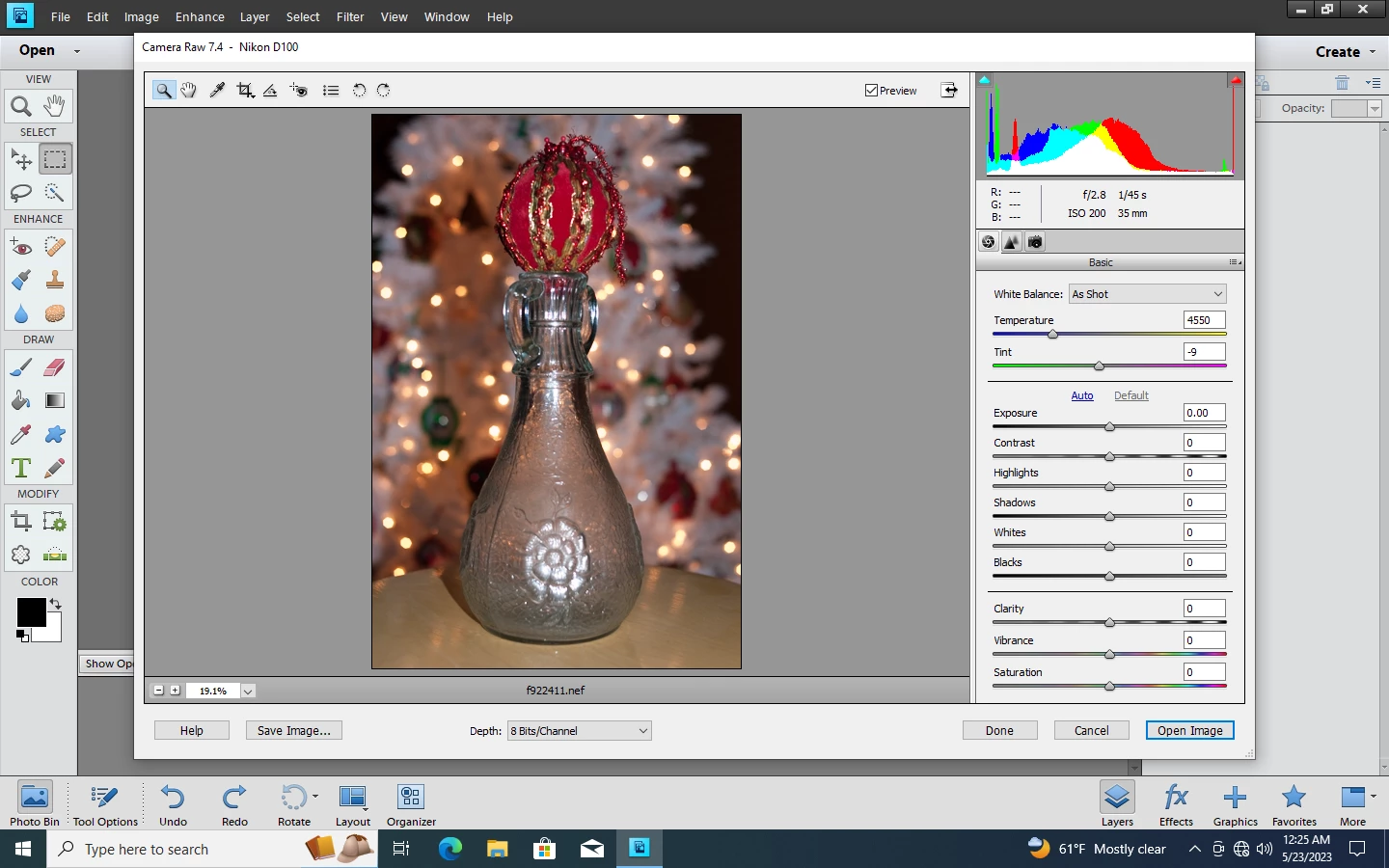

Thanks, Jeff.  I foolishly thought that the download link would install the latest version.  I didn't bother looking for Updates.  Elements 11 has now successfully updated to ACR 7.4 on my Windows 11 installation.

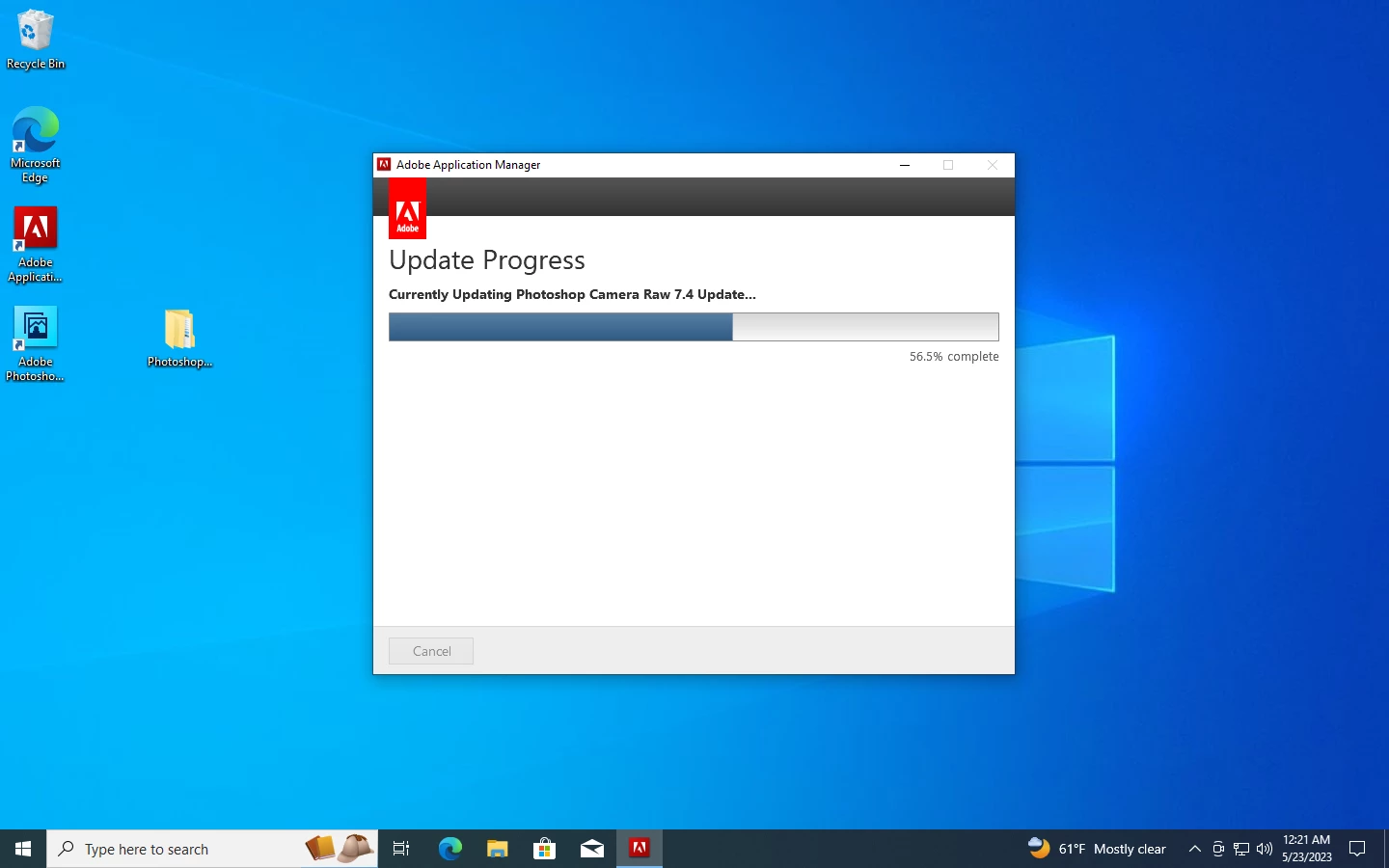

See if installing a more up to date Adobe Application Manager works:
http://download.adobe.com/pub/adobe/creativesuite/cc/win/ApplicationManager10.0_all.exe

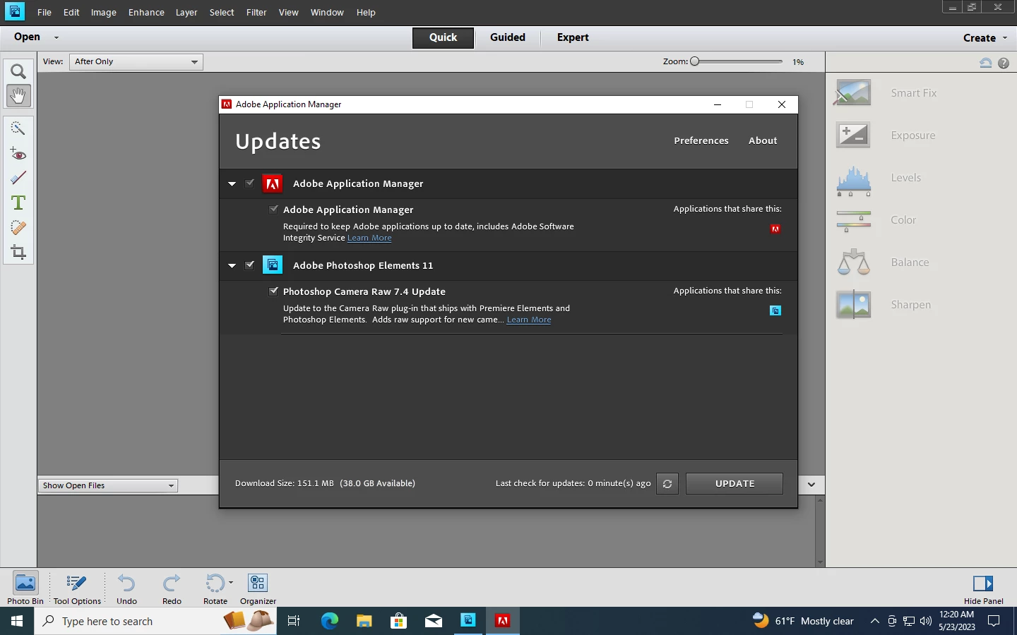

I just did a fresh Windows 10 x64 install with photoshop elements 11 and from within the photoshop elements editor, Help>Updates worked.
When you click on Help>Updates from within the photoshop elements editor, nothing happens?
