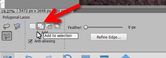

    If I understand you correctly, in the tool options bin, make sure that you have the Add option selected.  (I'm not sure why you are hitting the Esc key - that removes the current selection.)
    October 19, 2019
    Thank you so much Greg, that was just what I needed.
    I used Esc to remove the first selection because if I left it there the second selection failed. still learning!
