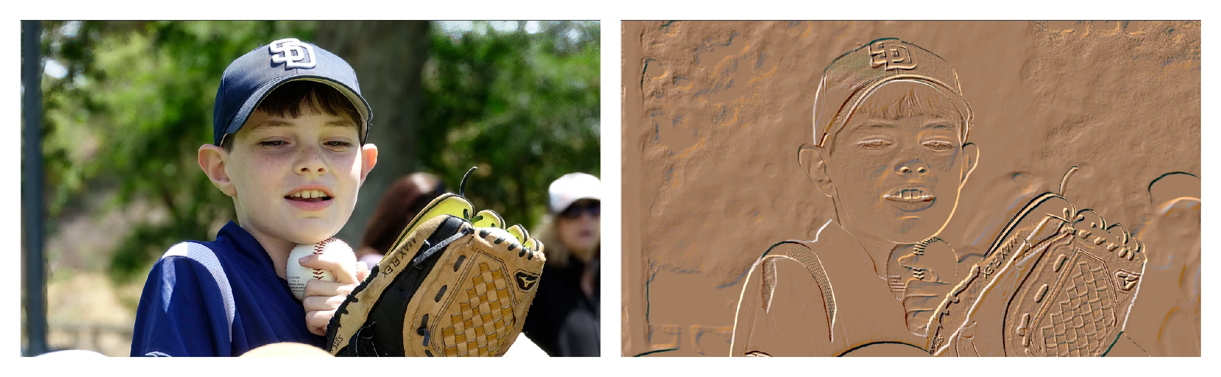

@Tony227, I just took another quick stab at this using the new Color Match feature in Elements 2024.  In the following example, I took a color photo and converted it to B&W.  I used the Emboss Filter (under the Stylize filter sub-menu).  Finally, I used the Color Match feature under Effects and used the Bob Hoffman image from the original post as a custom image.  Here is the result:
I expect it could be improved with some other editing.

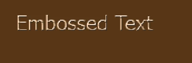

You can apply a bevel style to the text layer to give the embossed effect.

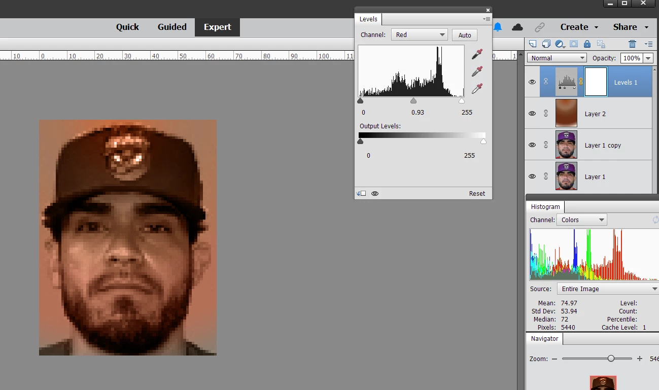

I don't have an artistic bone in my body, but here's what I came up with:
  1. Create a new layer
  2. Choose the Gradient tool and select the Copper preset gradient.
  3. Apply a gradient to the new layer.  You can use various options here and change to taste.  You can also modify the colors of the gradient, perhaps to make darker/lighter than the preset.
  4. Change the grandient layer's Blend Mode to Color.
  5. Optional:  Create a new Levels adjustment layer and play around with the Channels, particularly the Red and Green channels.

Thank you, Greg! That color is what I'm looking for. I am just struggling to figure out how to get the textured effect of the face too look all gold (or bronze or whatever it is) like in the original Bob Hoffman plaque.
The text also looks slightly textured, as though if you were to run your hand over it, you could feel it sticking out from the plaque itself.
