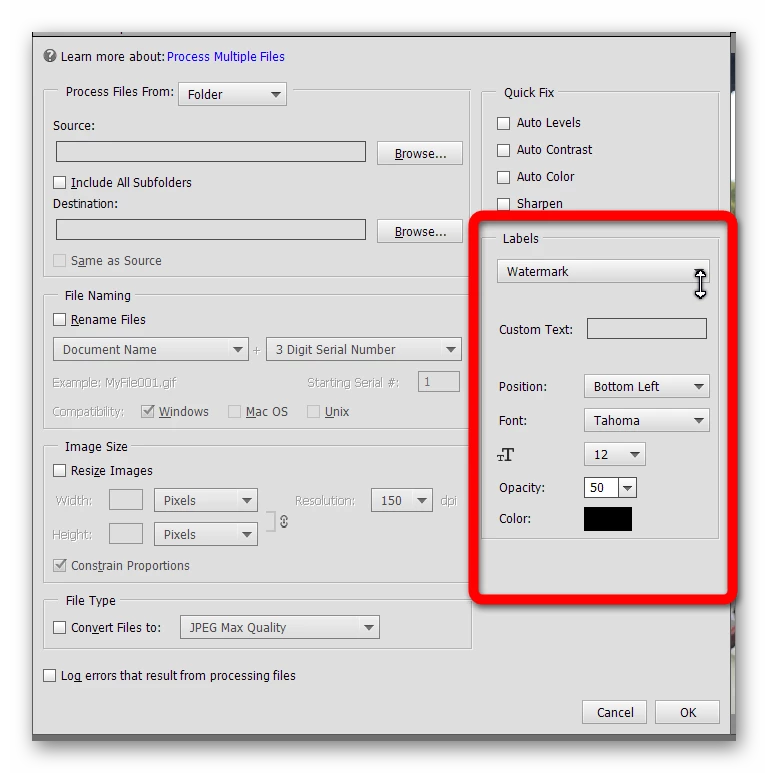

Apr 7, 2020 7:11 PM UTC
You can use the File>Process Multiple Files dialog to add a text watermark to multiple files.
If you need more assistance, check out this tutorial.
