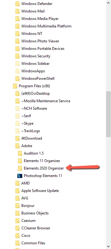

@johnb73471616 said:  In fact there are two sub folders with the same name. One is in folder Program Files and the other in folder Program Files (x86).  They are both on the C: drive.  I suspect the sub folder in Program Files may have been installed when I've been playing with different locations trying to get Premier installed.
The Elements Organizer 2020 folder should NOT be in the Program Files (x86) parent folder. (But that is where your Elements 11 Organizer folder should be.) As you say that you have been playing around with different locations, this is probably the cause of your problems.  My suggestion is that you uninstall both PRE 2020 and PSE 2020 from your computer.  Once you have uninstalled the programs (or even if the uninstall of PRE did not work), move the Program Files (x86)\Elements 2020 Organizer folder to another location.  I would tell you to delete it, but since it is not clear how much playing with locations you have done, I am suggesting to keep it for safety's sake until everything else is up and running.

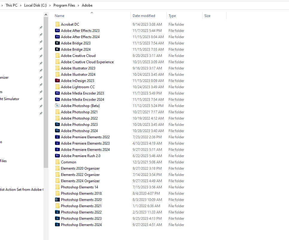

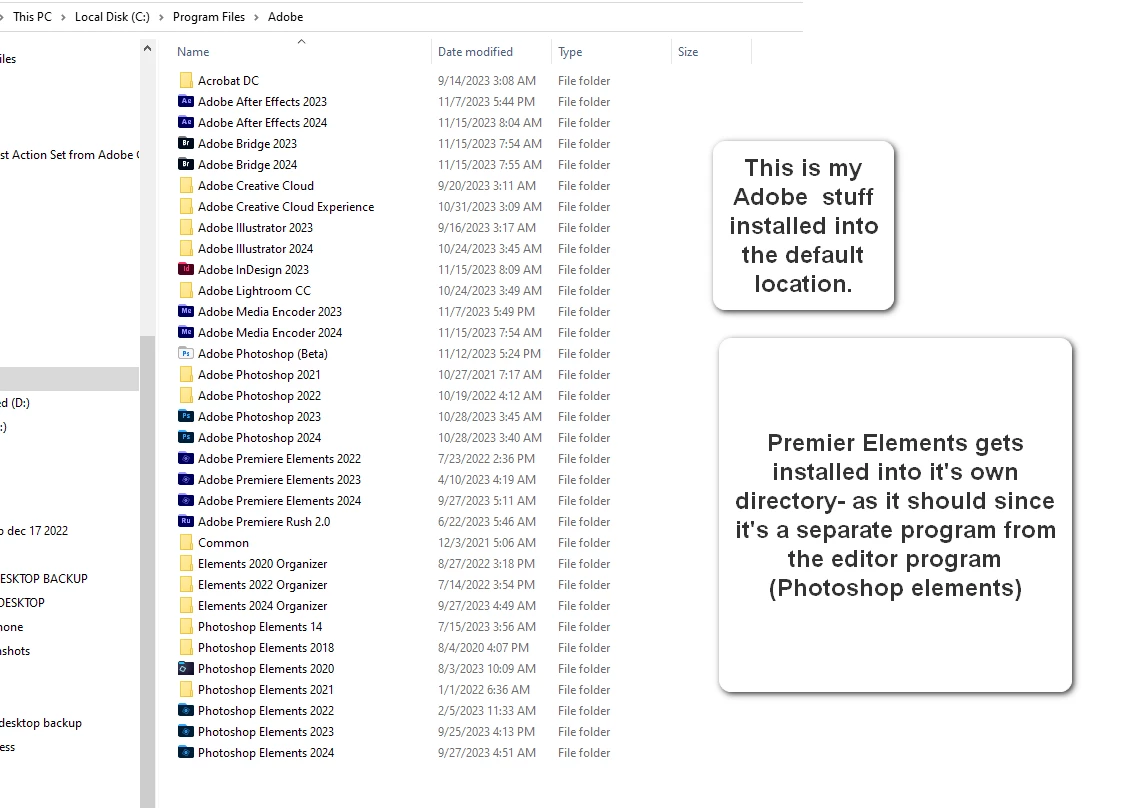

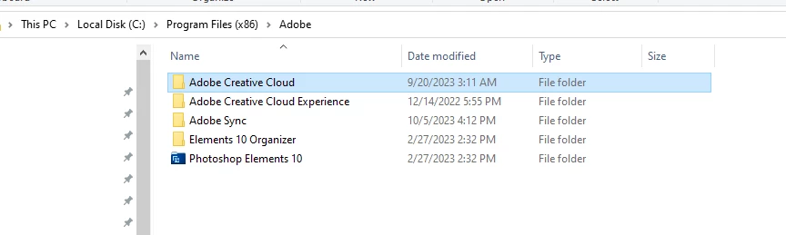

"Program Files (x86)" is used for 32-bit applications. Installing a 32-bit application in a PC with a 64-bit Windows automatically gets directed to Program Files (x86).   I've got a ton of versions installed- and in the same position as John depicted in his second post I only have the following.
That makes sense: That was a 32 bit version I had installed, so it would get installed automatically in the (x86) directory.
All my other Adobe stuff is installed here:
I don't have any idea why he has that folder for 2020 in his x86 directory--   it certainly doesn't belong there.
If it were me?  I'd be uninstalling everything all old versions of PSE and start over.

Here are some screen shots of the Elements 2020 sub folder. No I definitely did not create this myself.  In fact there are two sub folders with the same name. One is in folder Program Files and the other in folder Program Files (x86).  They are both on the C: drive.  I suspect the sub folder in Program Files may have been installed when I've been playing with different locations trying to get Premier installed.  BTW I've tried another tack this morning by redownloading the prem 2020 .exe file from my account using a different browser and making sure there are no Adobe files left running in Task Manager but I get exactly the same failure.

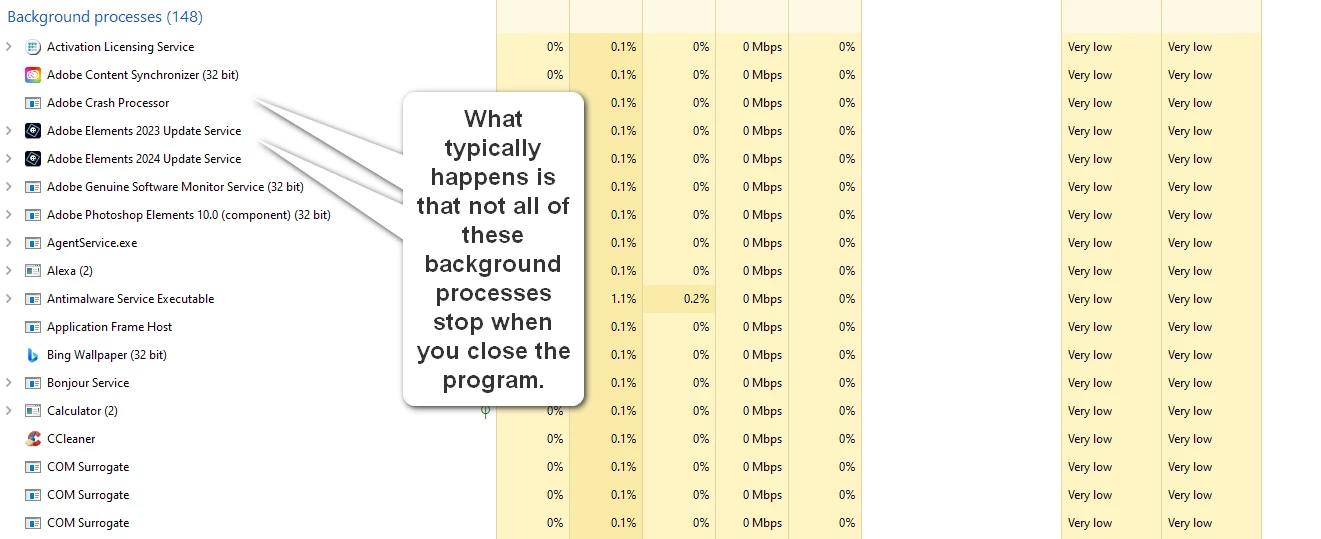

Elements 2020 is the editor.  Premier Elements edits videos.  When you have problems installing / reinstalling it typically is due to "parts" of the program still running in the background, even though you have closed it, it just happens sometimes.
View background processes as mini programs that do specific things.
There is more than one folder labelled "elements 2020" (or any other version) on your computer.
There really is no reason for the average user to be concerned with the processes you see listed below.  I have 4 or 5 adobe things open right now, that's why you see many Adobe things open.
I often used cCleaner to uninstall things, other use other utilities, I also just use the uninstall feature built into windows.  Use  whatever makes you happy.

Different parts of either program (PSE or premier elements) get installed into other locations-- no real reason for you to be concerned with those right now.
