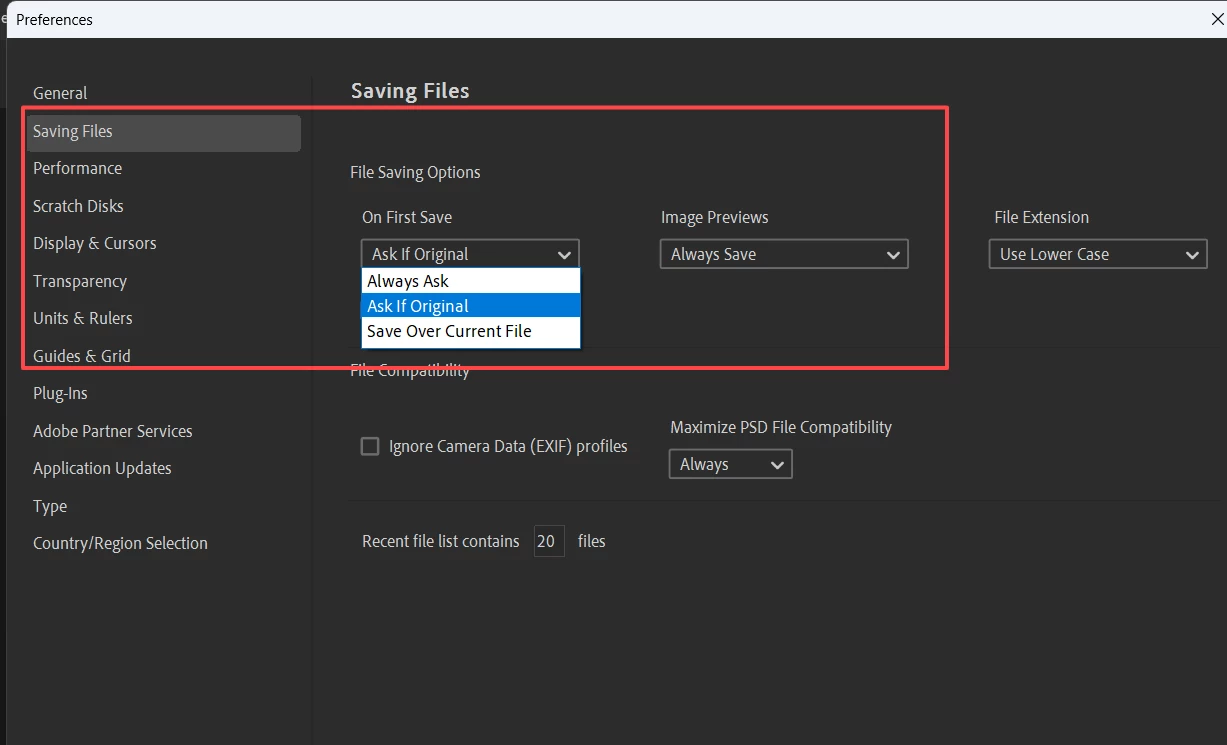

Oct 19, 2025 7:28 PM UTC
There are some bugs in the Save As dialog.  Choices to save in the Organizer are not sticky and Version Sets are not being saved when wanted or created when not wanted.
I have not yet tried this and I don't know whether this will help any, but try making some changes to the options in the Preferences>Saving Files dialog:
Oct 19, 2025 8:47 PM UTC
Thanks, i had tried that.  It seems that I have a bug. I have just tried my second PC and the same thing happens.  What a nusiance, but this bug is mportant.  Should I uninstall and try again on both computers.  Hope I do not have to pay again.
