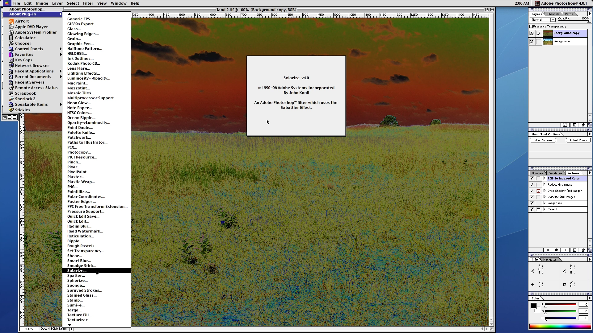

Jeff Arola
Aug 25, 2022 6:22 AM UTC
According to the About Plug-In>Solarize in photoshop 4.0.1, the Solarize filter is supposed to emulate the Sabattier Effect.
https://lostlightphotography.com/sabattier-effect-detailed-step-by-step-tutorial/
In other sources it is said that the Photoshop Solarize filter inverts all color values above 128 or 50%. Color values below 50% are unchanged.
