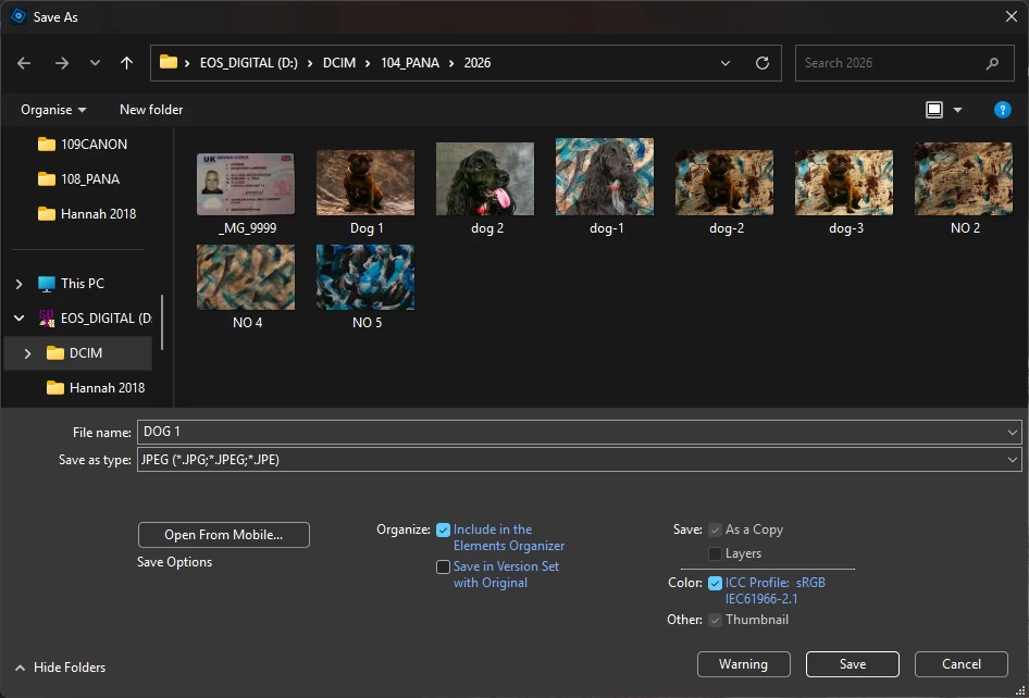

    I found all the replys were vauble, my question was answerd but i failed to get my photos saved  in JPEG. To bring you up to date i used Photo Editor where i have  i pushed my photos through all 2026 boxs without using layers etc..However I have made changes in Guided Edits and in RAW, they failed to save. . I have resized my photos from 16 bits to 8  - 1600x1200 pixels they have failed. When trying to save I have spotted the save as a copy light box goes dull like its failing to respond

    Your screenshots suggest that you are trying to save a file named DOG 1 into a folder that already has a file named dog 1.  This would be the same file as far as Windows is concerned and you would then get a warning that you are trying to overwrite a file with the same name.
    Having said that, there is a bug in Elements 2026 that does not automatically rename the file.  You have not answered whether you use the Organizer (to organize your files, not to edit them), although you have checked the box to save in the Organizer.  (This is probably the default whether you use the Organizer or not.)  I have found that there is a workaround to renaming the files automatically.  Simply check the Save in Version Set with Original box.  Or if it is already checked, toggle the box off and back on.
    Another issue I see is that you may be saving the file to a memory card.  Perhaps the card is full or is write-protected.

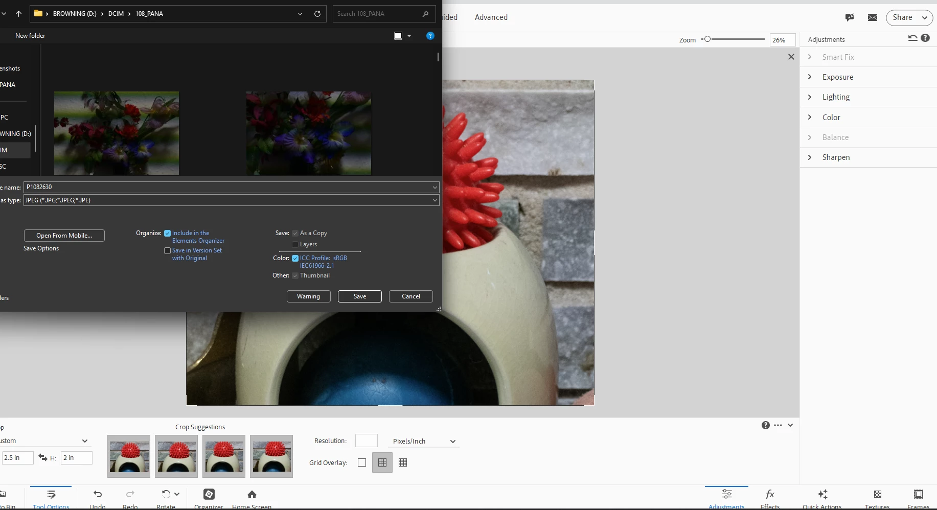

    Thank you for your reply . When I opened the warning box it suggestes  “the format must be saved as a copy”. Which i do. I have noticed when saving in JPEG the save a copy box goes dull  where in GIF PNG Tift etc it stays bright with no warning sign. Would you agree my fualt could be when trying to save in JPEG the save a copy tool is not active where in the others areas it works. Have you any ideals how a novice can do a fix? Looking forward in readying your reply

    Adobe is aware of problems with save as a copy and in a version set. We can expect the next update to fix this. But nobody knows the timescale so stay tuned.
    In the meantime try using save for web. Not ideal for prints but   JPEGs  are suitable for most other purposes.
