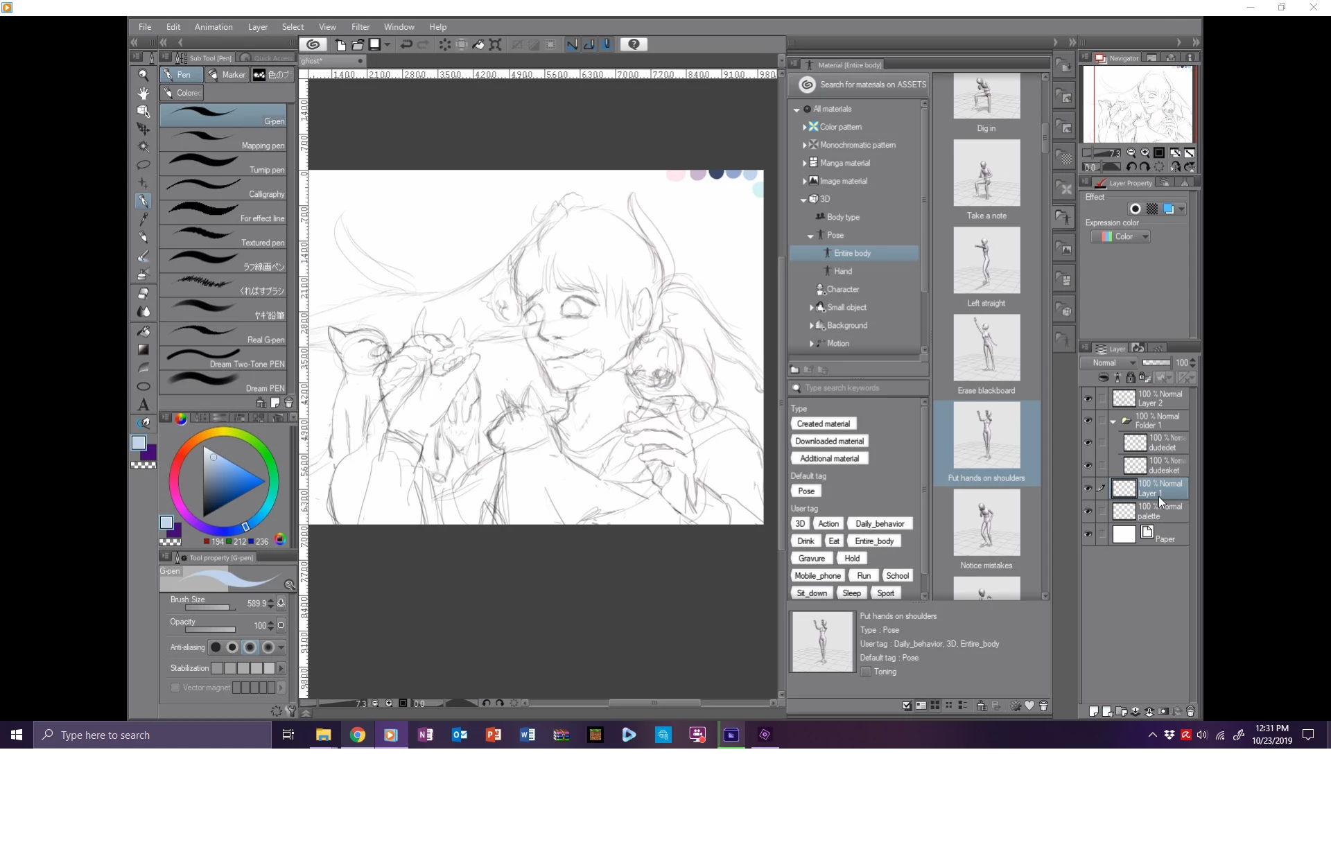

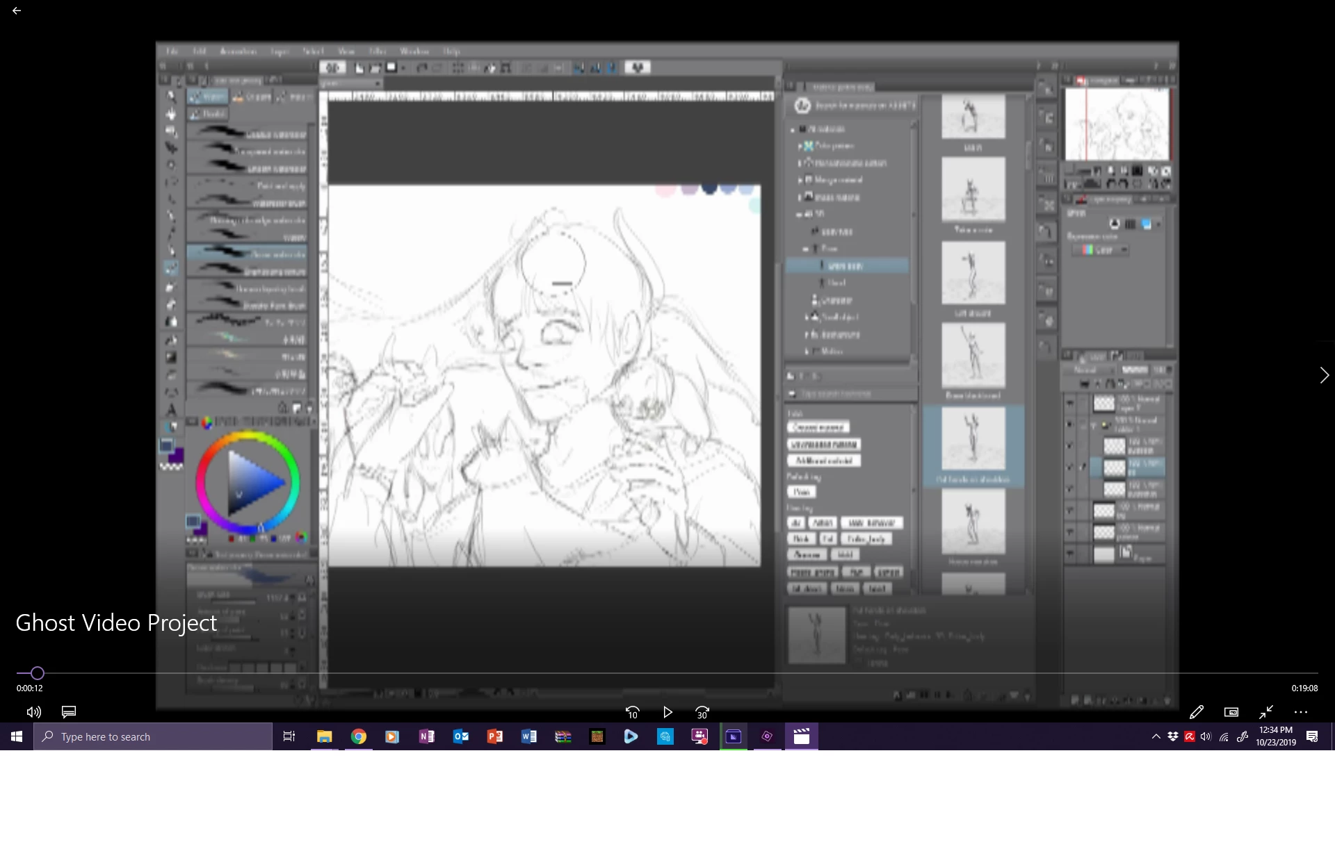

I screen record while I am drawing with flashback and the quality is great when I export it from the flashback editor (I only have the free version so I cannot edit videos in flashback.)
The top is great, you can read the text and video plays fine. The bottom is after I place it into premier, speed up the video, and then export it. It looks AWFUL and I am unsure of what to do because I have limited time. I have tried rendering the whole video before exporting at all the highest quality settings and nothing is changing.

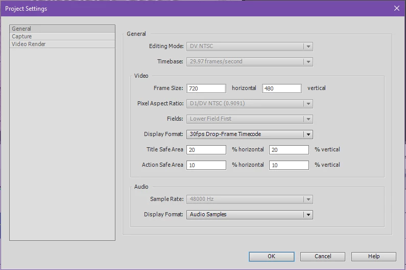

Your project is SD, but your export is HD, so it will be less clear when exported.
What are the pixel dimentions of the media you are putting on the timeline in Premiere Elements?

I think Peru Bob has the answer.  Your Flashback output is Brady Bunch resolution.  Elements doesn't have much to work with.
October 23, 2019
Alright, I had a hunch but wasn't sure. Now I have to find a good screen recording software. Thanks for the help.

October 23, 2019
OPE I forgot the project setting pictures too: Sorry I'm busy today

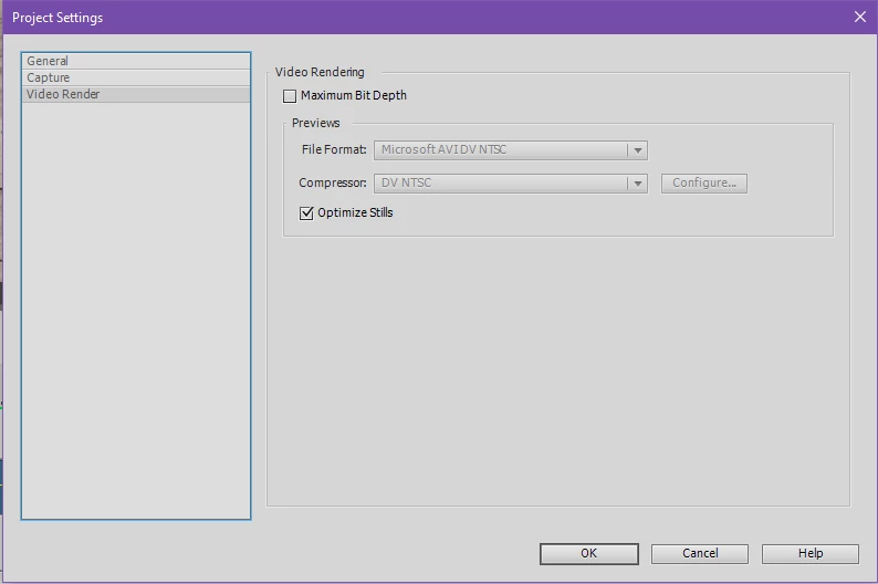

October 23, 2019
Please answer all of Ann's questions:
What resolution (pixels) did you do the screenrecording?
What are the project settings?

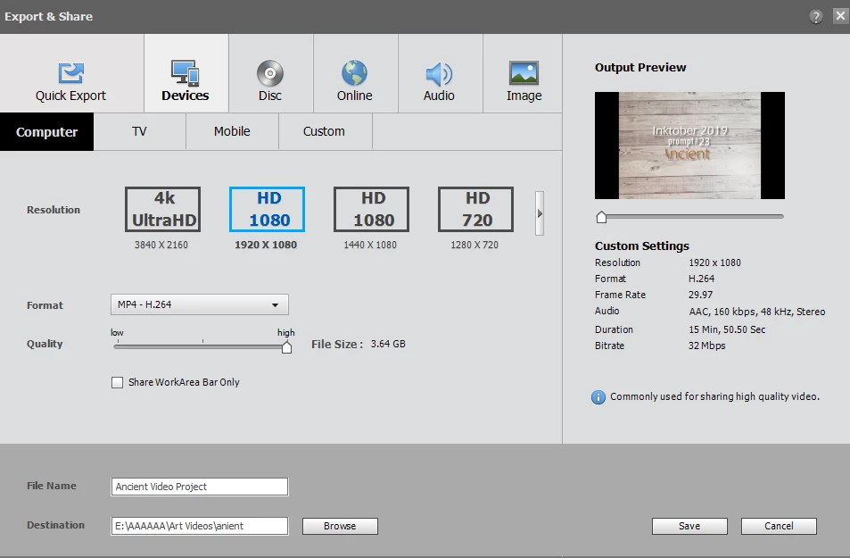

What are your export settings?
October 23, 2019
here are more specifics for premier if that helps.

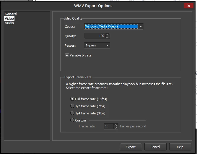

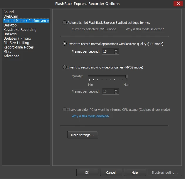

I use export and share and I have tried at every quality and a couple different custom qualities and none make a difference. I have rendered the movie before export as well and it doesn't seem to make a difference. I am not a pro, by any means, and did not expect this to be such an issue. I feel very in over my head.
Those are the general settings that I just leave them at because they work fine and I don't know a whole lot about how all this works. I'm unwilling to purchase the whole program because it records gameplay absolutly horrendously.
If it is my screencapturing software I am unsure what to use that Premier won't compress into garbage.
