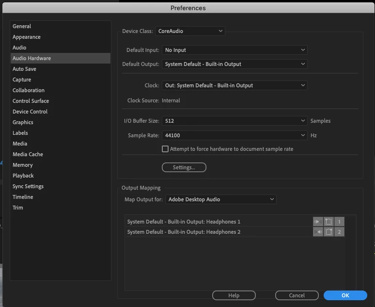

Ishan Y
Jan 4, 2023 7:49 PM UTC
Hey Michael,
This shouldn't be happening. Let us know which version of Premiere Pro you're currently using (Here's how to check). Try creating a new project and check if you still see the issue. Please share a screenshot of your Audio Hardware preferences if you still see the problem.
Ishan
Jan 6, 2023 12:40 PM UTC
Hi, thanks for you reply. I'm running version 15.4.1 (Build 6) but cannot update it any further due to not being able to update the OS on this machine past Mojave version 10.14.6.
I created a new project and imported the sequence I am working on and this did fix it, but all of a sudden it started doing it again.
Heres my Audio Hardware preferences
