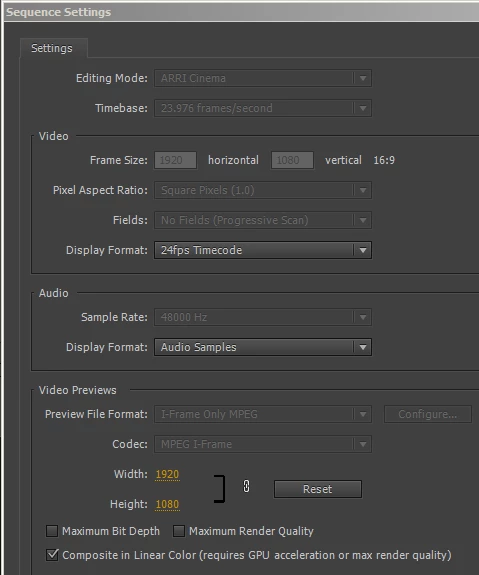

    You can go to the Sequence menu and ask for the Sequence Settings and you should see if you are viewing Drop Frame or Non-Drop Frame (24 or 23.976) in the Video box under Display settings.
    If you are trying to match things up, you might find that changing it over to "Frames" instead (temporarily?) might help you to find the solution to your issue.

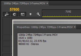

    I just put one minute of 24fps video from my Panasonic DMC-GH3 on a timeline. I then copied it over to create a 40 minute timeline.
    If I multiply 24 frames per second times 60 seconds, I get 1440 frames. Multiply 1440 by 40 and I get 57600 frames. I figured that would be long enough to detect any frame count issue.
    If I look at the timeline using 24fps as the setting, I see 40 minutes exactly. If I look at Frames, I see 57600. Therefore, footage shot at 24fps seems to be 24fps and not 23.976. Not so, as you have pointed out. So I looked deeper.
    My findings indicate that even though when I drop the footage on the "New Item" button I get this indicating that it shows up as 24fps but is being played at 23.976
    However, as I started to suspect using your information, if I look in the Sequence properties, I see it is longer than 40 minutes and yet the timeline says 40 minutes.
    The same thing showing frames:
    So that left me with the question of what the correct duration actually is. I get that the number of frames is just the number of frames no matter how fast they play back, but if the timeline says 40 minutes then it darn well ought to be 40 minutes. But it isn't!!!

    A sequence time-code setting of 24 only means that the system will count from 0 to 23 and then starts the frame count over again.  It doesn't indicate the actual time-base of the material.
    When you create a sequence, and choose a 24p present, you'll note that the preset description indicates the time-base is actually 23.976 -- because video does not run at 24fps.  All time-line timings should reflect that fact.
