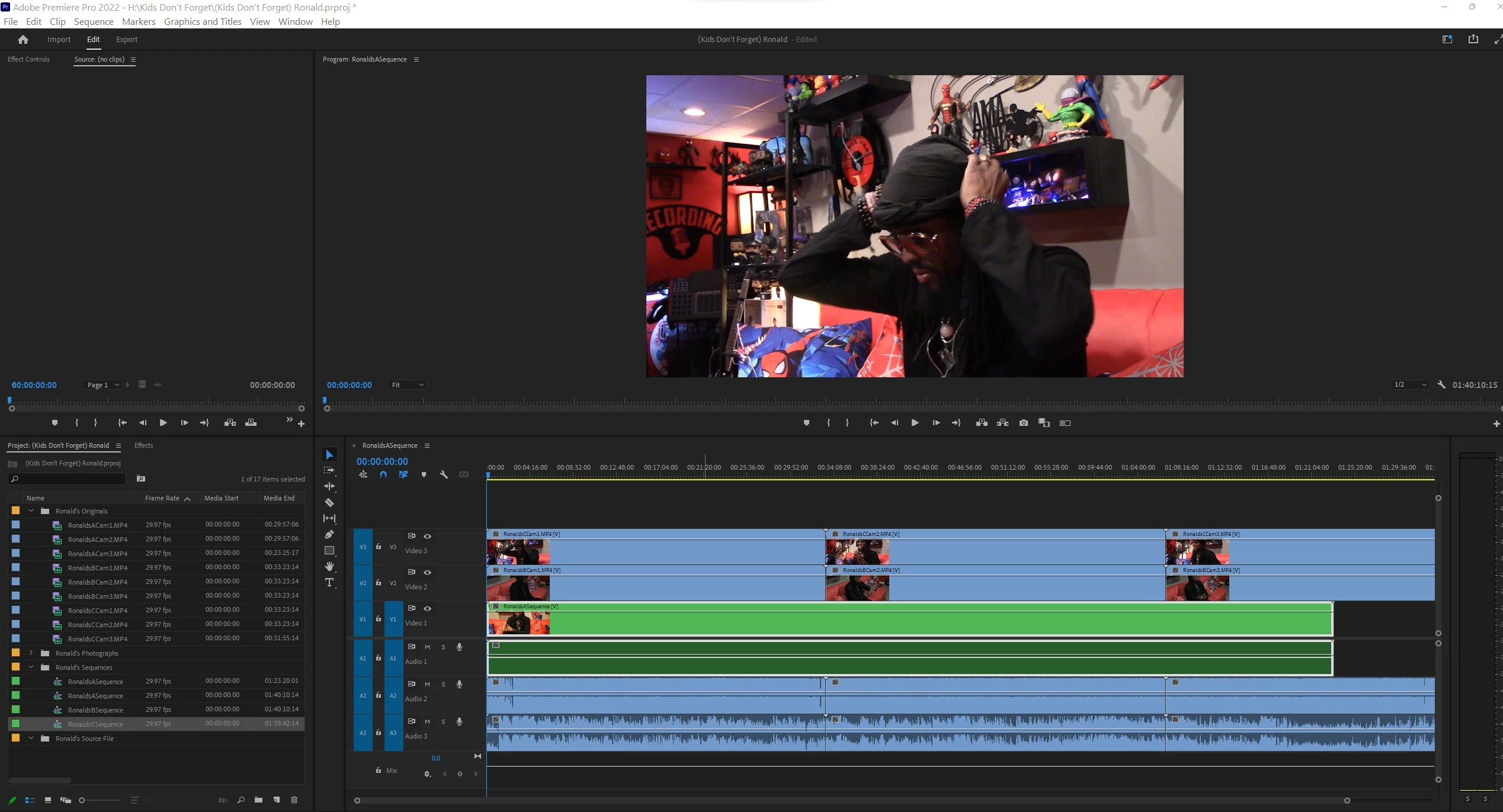

I have three video clips from three cameras all filmed simultaneously. One of the clips has no sound, so it will not multisource sync due to Premiere not being able to locate the nonexistant audio. So, what do I do in terms of matching the clip without audio? Help!

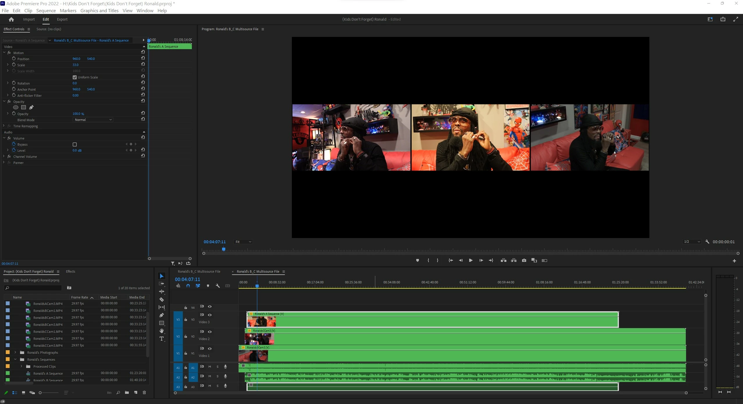

Well, then keep it simple. Sync the two, then add the no-audio clip and just place it close to where you think it should go. Then put a dissolve or crop on the top clip and then you can see the two tracks and nudge around the one without sound.

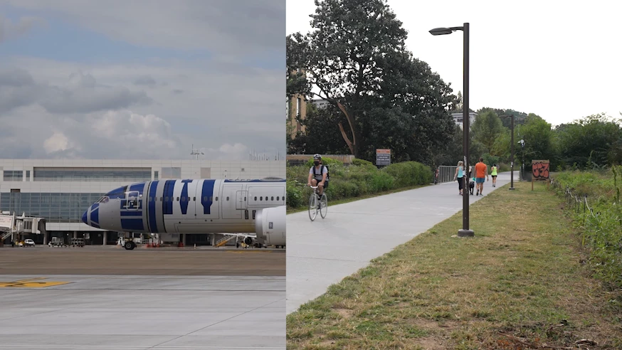

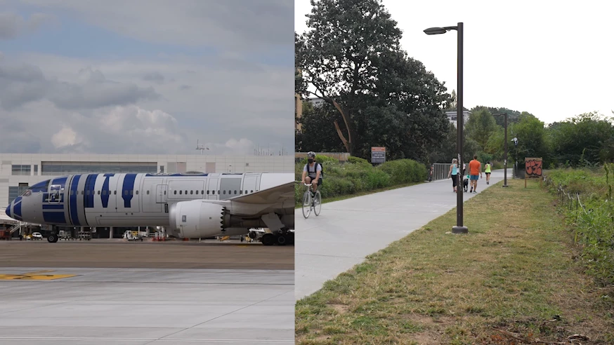

Also, you can change the "Blend Mode" on the top clip and see thru it a bit, or do a dissolve between them. Here's a quick crop to see both...

You can merge them when you get them sync'd. I was thinking you did a multi-cam sequence with the first two clips. Right-click the source sequence (in project) and 'open in timeline',  then drop clip 'a' into that multi-cam source sequence and line it up. Then when you have that done, right-click again in project and 'new sequence from clip' and you'll get an edting sequence you can use for the project, and the source sequence is there if you need to tweak the timing / placement of clip 'a'

So, first of all, you are a great help! That's A. My mind is open; I'm Googling & YouTubing a lot, in combination with the things you've stated. I'm experimenting - think I'm getting somewhere. So, not in the photo I inserted (that was the 2nd experiment), but I did create the B&C multisource first; anyway, back to that. The problem is, it won't let me drop the A clip into the timeline. So, I'm going to have to try using the source file.

It's easy enough. just drop that clip in with the others and eye-ball it as close to the others as you can. You can then nudge the clip into place. Use a 1/2 dissolve so you can see thru the clips and nudge it that way. Or simply look for some event happening on all three cameras to nudge the one into place.
