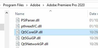

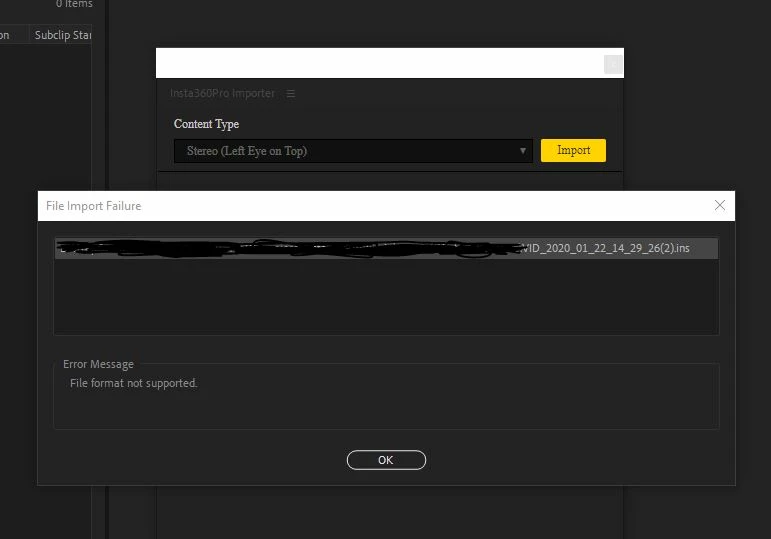

    Looks like this is still an issue.  I just installed the latest Stitcher for Insta360 Pro 1, and included the Premiere Plugins for PP 2020.  When I click on Extensions>Insta360 Pro Stitcher It opens the window, I select "Stereo (Left Eye on Top)" and then import the folder (with the .ins) file, and it tells me that it's an invalid file format:
    I also noticed that with 2020, there is no Qt5core.dll file, but a Qt5coreGP.dll file instead:
    It's the same for 2019.  Anyone found a solution?
