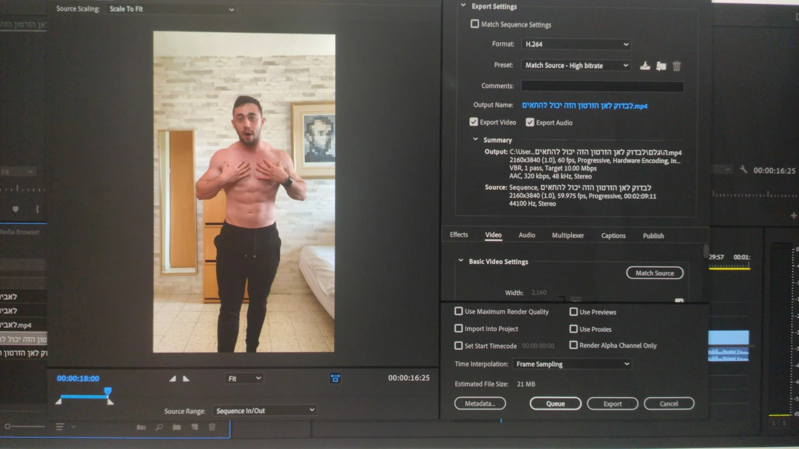

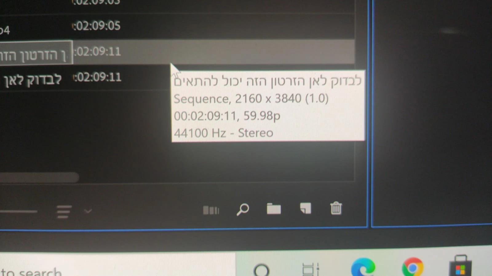

Hello everyone! really stuck on this one and could use some help. So I recieved this video from a freind. When I open it on my computer with VLC it plays just fine, the problem starts when I start using this video in any adobe program. When I playd the video initially it lagged (played very choppy). At first I thought the problem might be with the settings, I checked, and the settings - 2160 x 3840 at 59.98fps (vertical filming) matched the sequence settings. I tried exporting the file at a lower bit rate, and the export was lagging as well. I tried changing it to mp4 with media encoder, to 4k and full hd, in both attemts the result was also lagging.
As i need to edit this video already i sent the original version, the one that hasent been thouched by any program on my laptop, and sent it to diffrent freind who also edits with premier. When he opend the file that I was having trouble with it worked just fine on his pc. He sent me a version that was on mp4 format and works just fine with premier.
What could be the problem?
I know this is a heavy file, but my laptop handels 4k files, and the specs are 10th gen I7 6 cores, rtx 2060, 16gb ram.
Any help would be very helpfull! I might run in to this problem in the future and wish to resolve it before it happens!

I tried using your method and the pro res file was lagging as well :(. what really bugs me about the whole thing is that the file runs smoothly on a the pc of a friend that has lower specs. why is it that no matter what i cant reformat the video to run smoothly on my laptop, but my freinds computer was having no problem doing so?
I guess what i worte was more of a rant of frostration than helpful information.
I will look into what you wrote as it is alot of information. but as of know still no fix.

Hi Andy, thank you for replying! lowering playback resoulutin hasent helped! a freind of mine that uses a pc with lower specs sais the viseo runs smoothly on premier.
