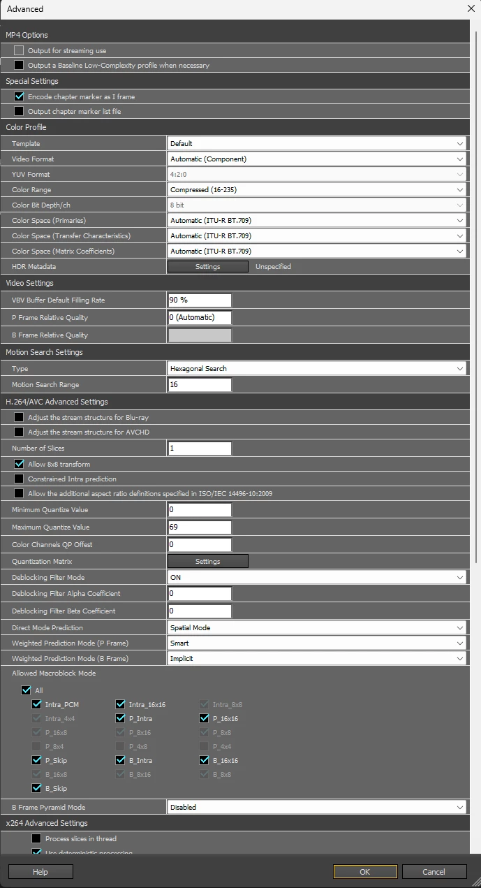

What settings should I use for TMPGEnc encoding? I think I just selected "High" and left everything else at the default.
Are there some further tweaks I should do?
Also, are there any other exporting settings I should try before purchasing TMPGEnc?
Thanks!
Averdahl
November 27, 2022
quote
What settings should I use for TMPGEnc encoding? I think I just selected "High" and left everything else at the default. Are there some further tweaks I should do?
By @Tripecac2
Regarding tweaking settings for the TMPGEnc encoder you can enter more settings by clicking the TOP-LEVEL VIDEO PARAM GROUP > More > Advanced in the Export tab if you use CC2023 or just click the Advanced button in AME or previous versions of Premiere Pro.
This opens a big Rabbit Hole of settings, so one must do some serious reading to know what to do and why/why not. All those settings are way over my head so unfortunately i cannot provide you with any help there.
If you locate one of the sections that looks bad on your timeline and export those 10-20 seconds as QuickTime > Apple ProRes LT and then upload that file directly to YouTube, how does it look when uploaded? And how does it look on the timeline before you export it?

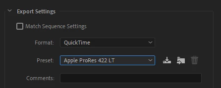

By using a higher bitrate when exporting to start with. 75/100 for 60p 4K is very low and YouTube will recompress it again making it look as it does today. Go with Constant Bitrate and skip VBR.
I prefer exporting direct to either Apple ProRes or GoPro CineForm and upload that file. The good thing is that it will look great and the bad thing is that the file is large and will take longer time to upload. If you have a good internet connection that is not a problem.
Try to export a couple of seconds were you see issues now using the settings below and upload that to YouTube and compare the two. (Yes, even ProRes 422 LT is great for YT uploads.)
