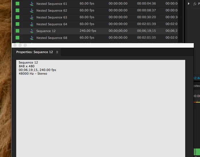

You can do all this inside Premier
Not sure why people will always assume they know best instead of just answering the question. Of course if you film at 120 or 240 you will want a sequence to be in 120 or 240 so when you you reduce the speed of the clip to 10% that 240 fps is now 24fps and really smooth. if you put a 240pfs clip in a 30fps sequence it drops all your extra frames and if you slow it down to 10% you will only have around 3fps which looks like crap
People should not ask why you want to do something a certain way and just answer the question
Its easy
right click on the clip in the in the project window and select create sequence from clip, then you will have a 240fps or what ever frame rate it was filmed at.  Then once you stretch the clip where ever you want it to be slow mo, you can copy to a master sequence if you have one at a lower framerate where your putting a lot of footage together that is at different speeds, or just export it at the 30fps with out losing any of the frames where you stretched it so you will have 24fps slow motion if you reduce its speed to 10%

October 30, 2014
if you interprat footage to 24fps then the whole clip is changed to 24fps. thats fine if you want to slow down the whole clip. But what if you do not.
as far as my comment "Not sure why people will always assume they know best instead of just answering the question"
It was becuase it seemed like the topic was getting off on a tagent of "Why would you want to do that", and "Most hardware will not support it" etc etc instead of just answering the question.
yes the only reason even I can think of using 120 or 240 its to for slow-mo but that does not mean you may want to slow down the whole clip, you may just not want to have to stop recording everytime and through your camra in 30fps for all your shots you dont want to slow down, if your wearing a gopro and think you may want to slow down a shot as you go off a jump or something, your not going to want to take it off to change the settings while your out there catching a wave, or skiing down a hill. You will record it at 120 and slow down the parts you want and keep the others normal.
But as the Adobe Staff parson stated....
Premiere Pro's renderer is framerate agnostic, don't let the lack of sequence presets stop you. Dragging a 120fps clip to the new sequence icon and internally it will be treated as 120fps.
Which is 100% correct by the way.
this statemnet
No it doesn't - as I said it will create a 59.94 sequence and the clip will play back at half-speed.
Is not correct.. AT ALL
If you create a sequence from a clip at 120 or 240fps it WILL create a sequence at that frame rate.
you can the edit your footage as normal, you can the slow down the parts you want and everything is there.
My point is was it seems a lot of people got of on a tangent of saying. "What would you ever want to do that for" instead of just saying how to do it.
and how to do it is "Create a sequence from the clip"
As the Adobe Staff person stated.
but thats the same as right clicking on the clip in the project and selecting "create squence from clip"
Sorry If i came across critcal it was not my intention I was just making an observation.
And regard to putting a 240 into a 24, i was referring to doing that only after you had finished slowing down any of the parts you wanted to.
If you had a master squence at 24fps or 30 or whatever, that contained what would be the final version of all your clips put together, justt dragging a 240 fps to it would drop frames, but you had alreaded edited your footage on the 240fps sequence and you had already doubled, trippled or whatever any of the frames where you changed the duration of the clip so it will look fine when you move it to a 24fps seq after any time changes were done in the 240fps sequence.
