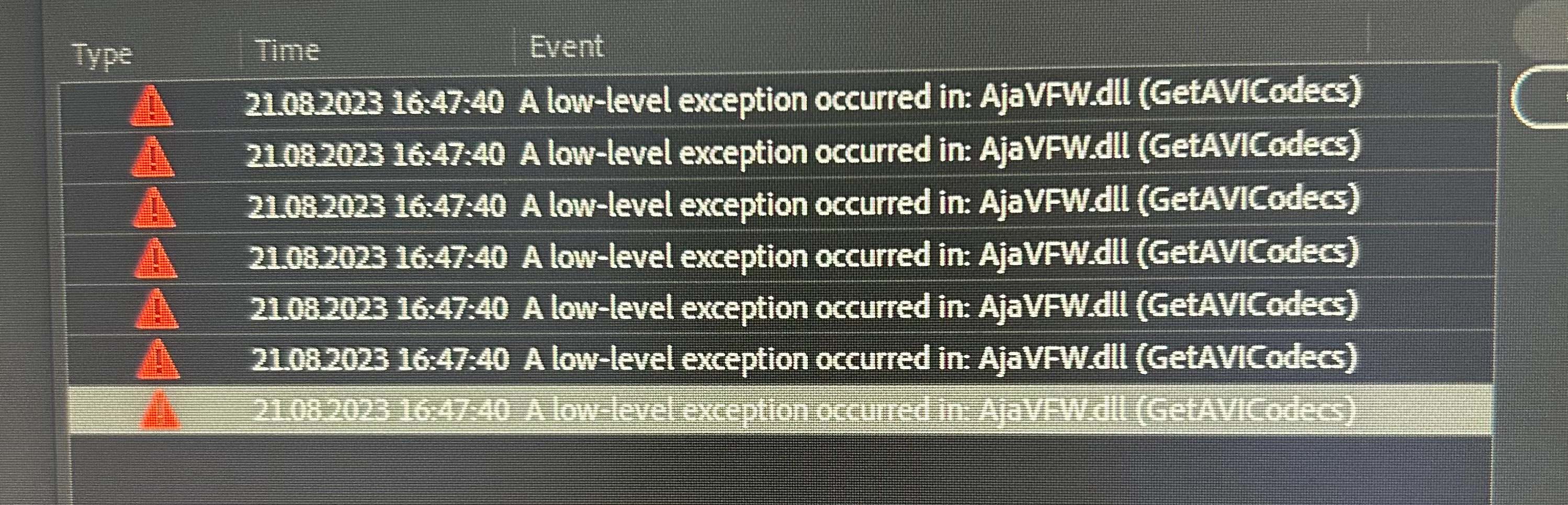

A low-level exception occurred in: AjaVFW.dll (GetAVICodecs)
  • August 21, 2023
  • 587 views
this error did show up and I do have problems with the Audio playback in my timeline...
When I playback the Video + Audio in my timeline it suddenly start's to have dropouts and I can't hear anything for at least 2-4 sec. before it starts to work normally again...
if I playback the part again this doesn't happen... but it start to dropout on other parts in the timeline...
does anyone have an idea how to fix this Problem?
Kind regards,
Julius

First thing, Please tell us your system specs: OS version, Premiere version, amount of RAM, Hardware specs including graphics card and your scource properties and sequence settings...    Since it's an audio problem, first troubleshooting step is to go to preferences: audio hardware and change the input to "none."
Since your screen shot seems to indicate a problem with something to do with Aja, do you have an Aja card or external peripheral connected?  If so, I'd reach out to Aja...   What is your audio output device?
