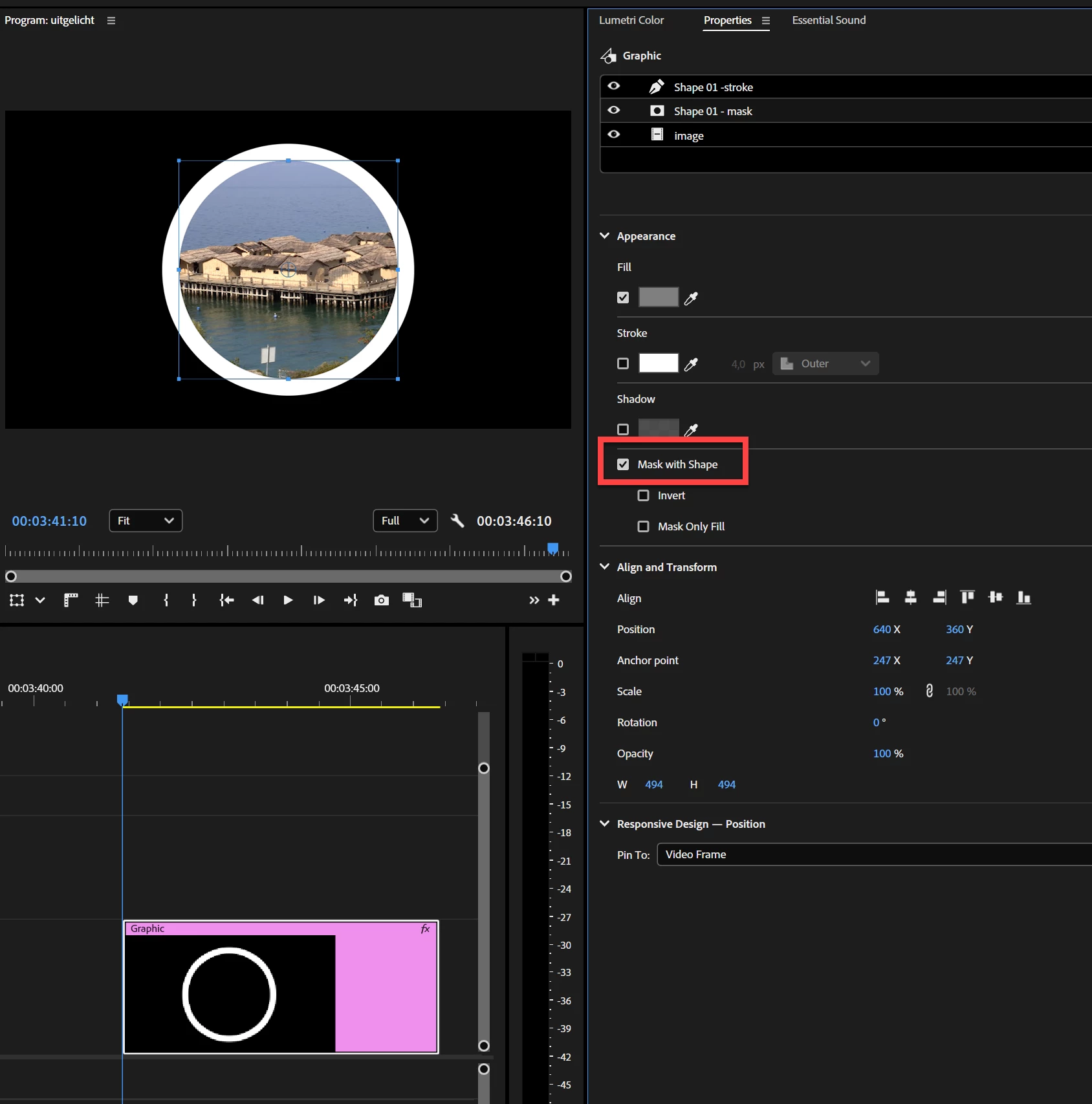

Why not use the properties panel all the way : quick and easy to make a pip.
Use Vector Motion to move the entire pip around the frame.
Circle and image can be manipulated independently of each other.

Ann BensCommunity ExpertCorrect answer
February 15, 2025
