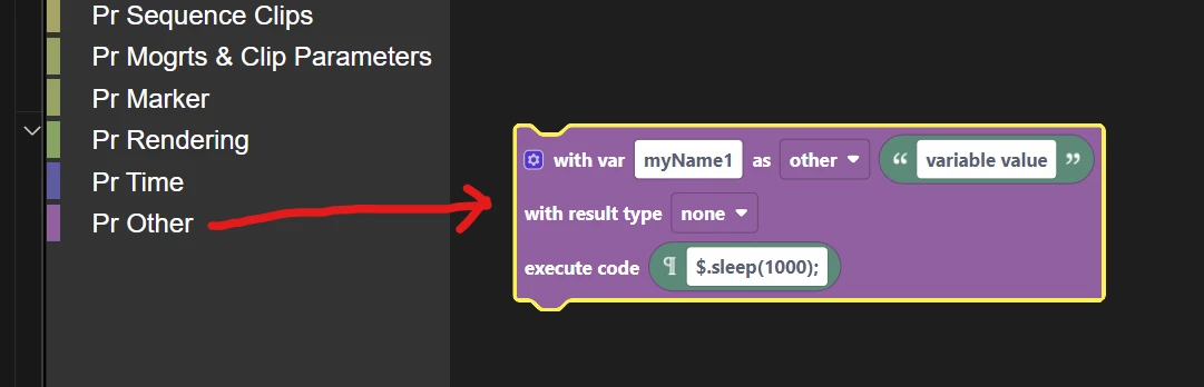

Well the extendscript command to wait is:
$.sleep(1000);
Where 1000 can be any amount of milliseconds.
And while I'm not very familiar with Automation Blocks myself, it looks like you can run custom extendscript commands via the "Pr Other" option then put the above command into the 'execute code' field, like this:
Which you should be able to place into your existing while loop.

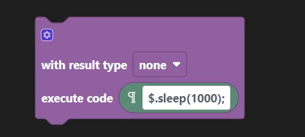

Optionally if you want to simplify the look of it, since clicking "Pr Other" seems to add the variable stuff which isn't actually necessary here, it looks like you can click the gear on the block and select and delete the 'item' thing, which leaves just the execution part like this below.
