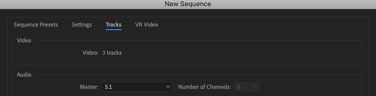

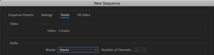

Brandon Loshe
June 20, 2021
Hi @parksdesign,
No problem. I would receommend creating two sequences. On sequence will be for the stereo version. And the other sequence will be for the 5.1 release. The channel format has to be set at the time when you create your sequence.
After you create you 5.1 master, make sure that each mono track is pointed toward the correct speaker.
When you are finished, if you have your sequence set to 5.1 as the master, then in your export settings, you'll see an option to export in 5.1 under the supported video formats.
Hope this helps!
