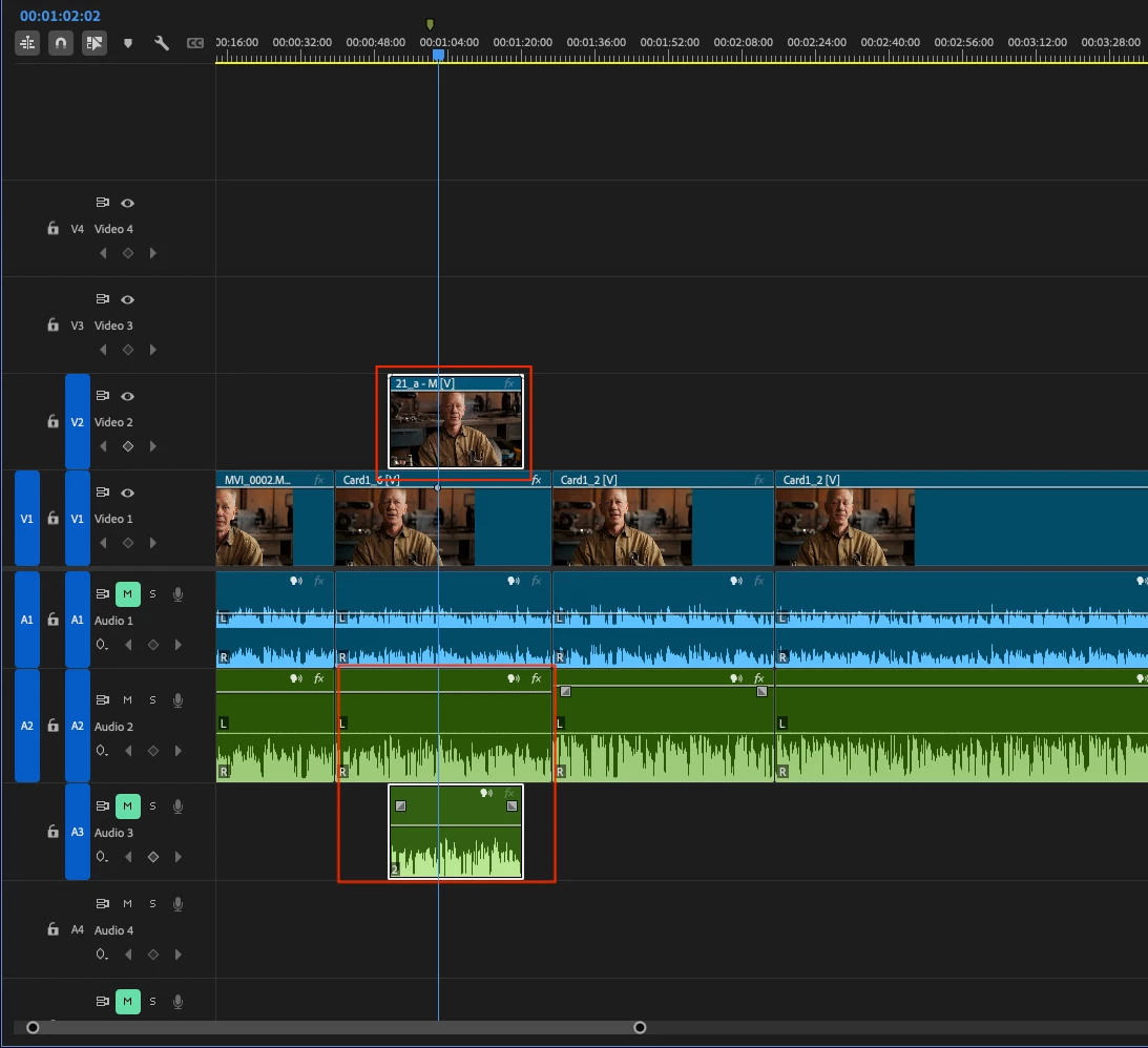

I'm editing an interview with a main camera shot and then some shorter 10-20sec alternate angle shots.
I have about 20 of these alternate angles I want to drop in but I don't know how to synchronise them with the main timeline.
The interview is edited down on the main camera and I used a Zoom recorder to get nice audio, so I have the two camera channels (A/V) and the 2nd audio channel. I can easily synch the Zoom video to the smaller clips I want to drop in so they have clean audio too...but I can't figure out how to synchronise those b-roll clips into the main timeline...(some of my efforts synchronised the main sound with the b roll...but moving it out of synch with the overall interview main sequence)?
I know from other research that I should have probably shot the b-roll continuosly for the whole interview and synched it all once for a multicam set up ....but I didn't do that and now seems like it's complicated to sych up the small clips!
Appreciate any help you can offer!
Alan.

as73Author
August 4, 2025
Thanks Paul,

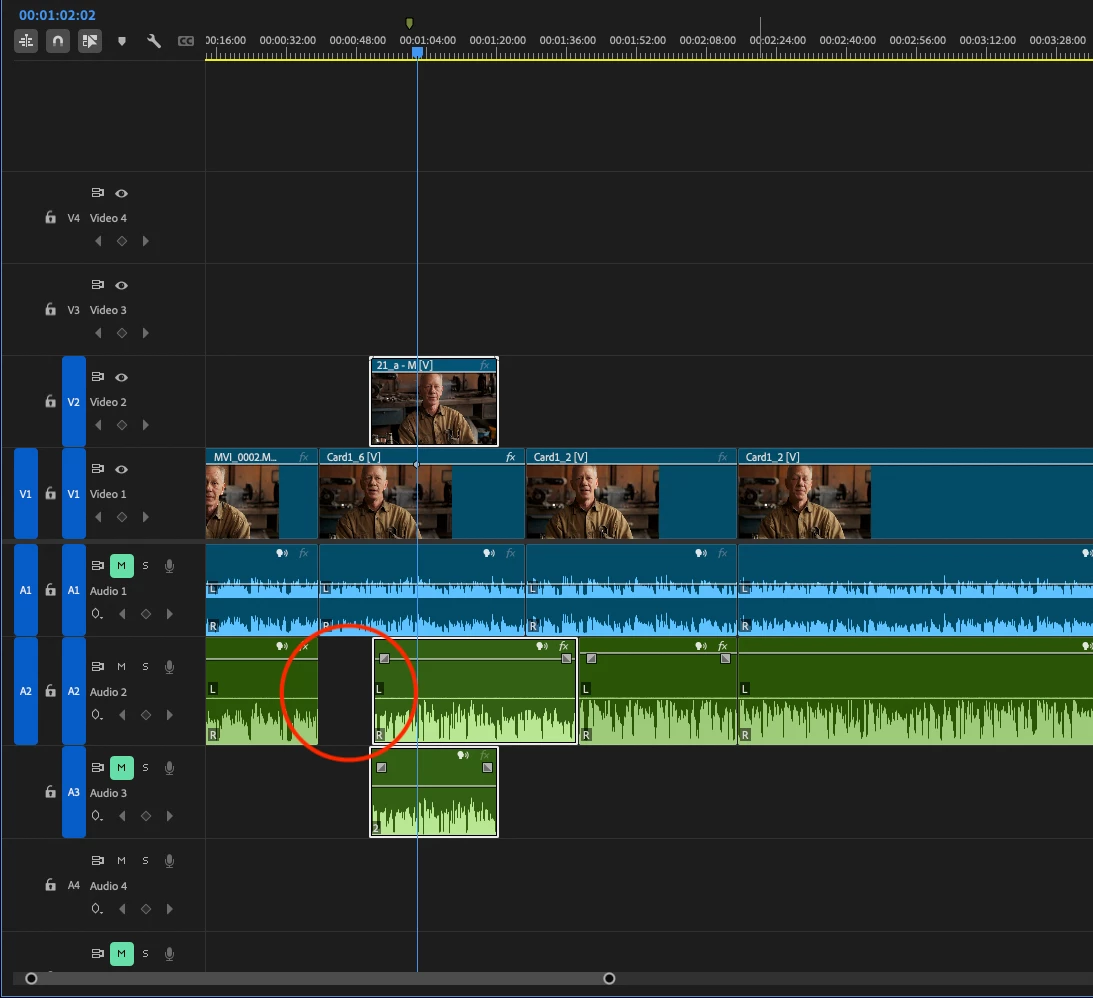

That's what I'm trying to do but I seem to be synching the timeline audio (which is all good and in synch with the main interview...so I don't want to change that) with the new b-roll clip instead of the other way around? What am I doing wrong?
See screenshots...I'm selecting the b-roll audio/ video chanels and selecting the main (Zoom) audio chanel and synching by selecting "Audio" and Channel 2 in the drop down menu....but in the second screenshot you can see where it's moved the main audio so now it's out of synch with the interview and that piece of audio is only in synch with the 10sec of b-roll....?
Appreciate any guidance you can give me, thanks!
PaulMurphyCommunity ExpertCorrect answer
August 4, 2025
The Synchronize function in Premiere Pro moves the clip that appears earlier on the timeline to match the one that comes later. If your B‑roll is placed after the main (Zoom) audio, it will shift the main audio instead.
To keep your interview in sync, place the B‑roll clip before the main audio when syncing.
