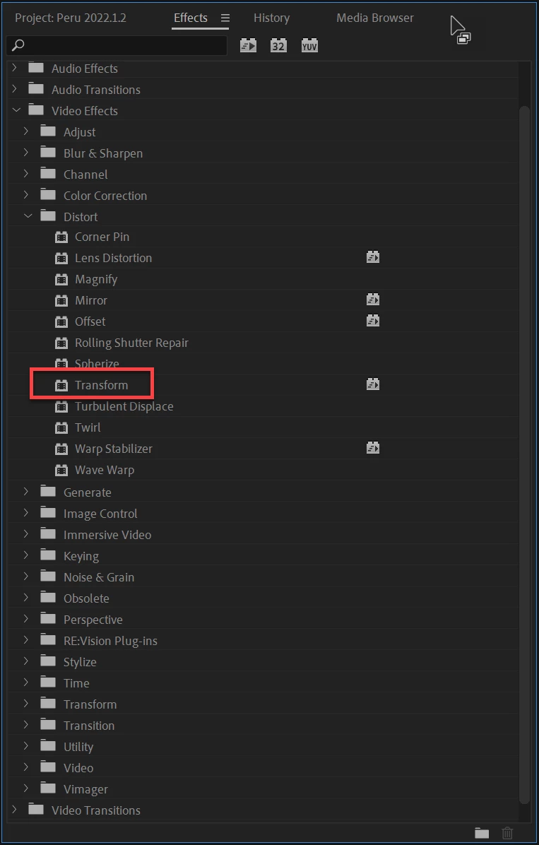

Use the Transform effect on the AL.

Thank you Ann and R. Neil.  The answer I needed was that Adjustment Layers don't deal with motion.  I have found an alternate approach.  I am confused about your solution.  "Transform" is a group of 5 effects, such as Horizontal Flip, etc.
None of them appear to be anything that would allow an Adjustment Layer to handle motion.

Read my post again:  Transform effect not Transform folder/bin.
Try and use the search feature.
