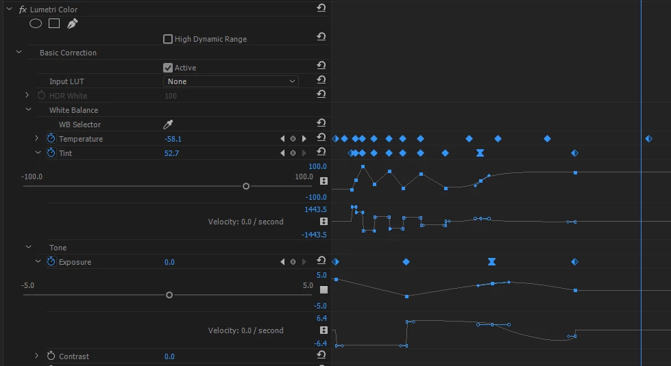

Does anyone know of any other way to edit the key frames?... in the event that we have multiple key frames (example screenshot below) - to bring them closer together or push them further apart (proportionately)?  Without having to manually move each key frame in the sequence, which would be an enormously time consuming task.
Below is a screenshot of an example of what might be the situation with the animation of the effects in the effect panel time line key frames.  Again, I want to either squeeze the key frames closer together (proportionately) to speed up the animation of the effect.  Or I might want to stretch them out away from each other (proportionately) to slow down the animation of the effect.  If not the rate stretch tool, then how?
Any input would be much appreciated.
