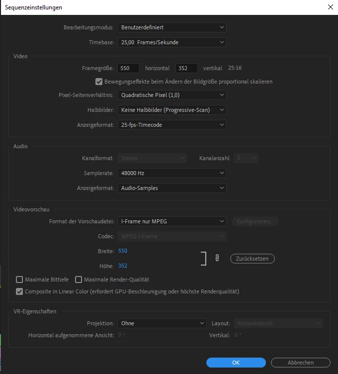

Correct answer Mike Dziennik
Ok, so I can replicate your issue and it is due to the resolution of your sequence and it's modulus. Change your sequence to 552 wide rather than 550 (which is not divisible by 4,8) and that will fix it.

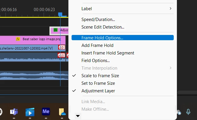

October 10, 2022
Ok I just got this issue also, right click on the adjustment layer in the timeline and at the bottom make sure
adjustment layer
scale to frame size is checked. This fixed it for me.

Mike DziennikCommunity ExpertCorrect answer
January 7, 2020

January 7, 2020
What are your sequence settings and clip resolution? Are clips scaled to fit into your sequence?
I can get the same 'edge' by scaling down an adjustment layer with lumetri but I don't get it when adjustment layer is at 100%.
January 7, 2020
these are my sequence settings (sry for the german)
It's for web usage so it's pretty small, when I created the adjustment layer I made sure it had the same resolution as my sequence and it's at 100% scale, so nothing from my side.
My camera footage is scaled but I'm not sure how that would affect the adjustment layer and even if I set it to 100 scale the edge stays.
