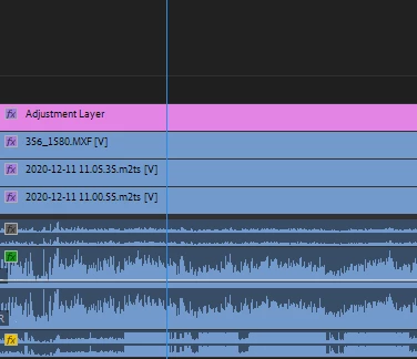

I encountered a problem, when I used multicam sequence editing, the adjustment layer didn't work. Usually I add a color adjustment layer to the top layer of the multicam footage to make them unified. But it didn't work in the 2020 version, and there is no problem in 2019. Is this a bug?

my footage use sony fs5 and fs7 slog3 shoot,Usually I use 709lut, it looks good in the multicam footage sequence, but it doesn’t work in the editing sequence.

Ok, I see your problem. When you enable multicam for a nest, the program treats each layer as a "camera", so it is reading your adjustment layer just as another camera, not as an adjustment.
I suggest you move the adjustment to the main sequence on top of the nest and not inside of it.
