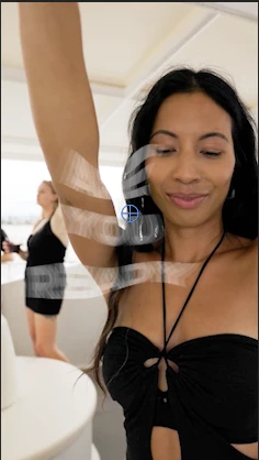

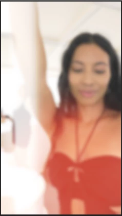

I have a preset on an adjustment layer for a transition but when the text layer is above or beneath it at the same time the adjustment layer transition is invisible and doesnt work until the text layer isnt there? Not sure how I can add text over the video and have the adjustment layer used for transitions over everything beneath it? The preset on adjustment layer works fine as soon as I remove the text layer?
Have posted images of the shot with the text layer visible and when it's not.
