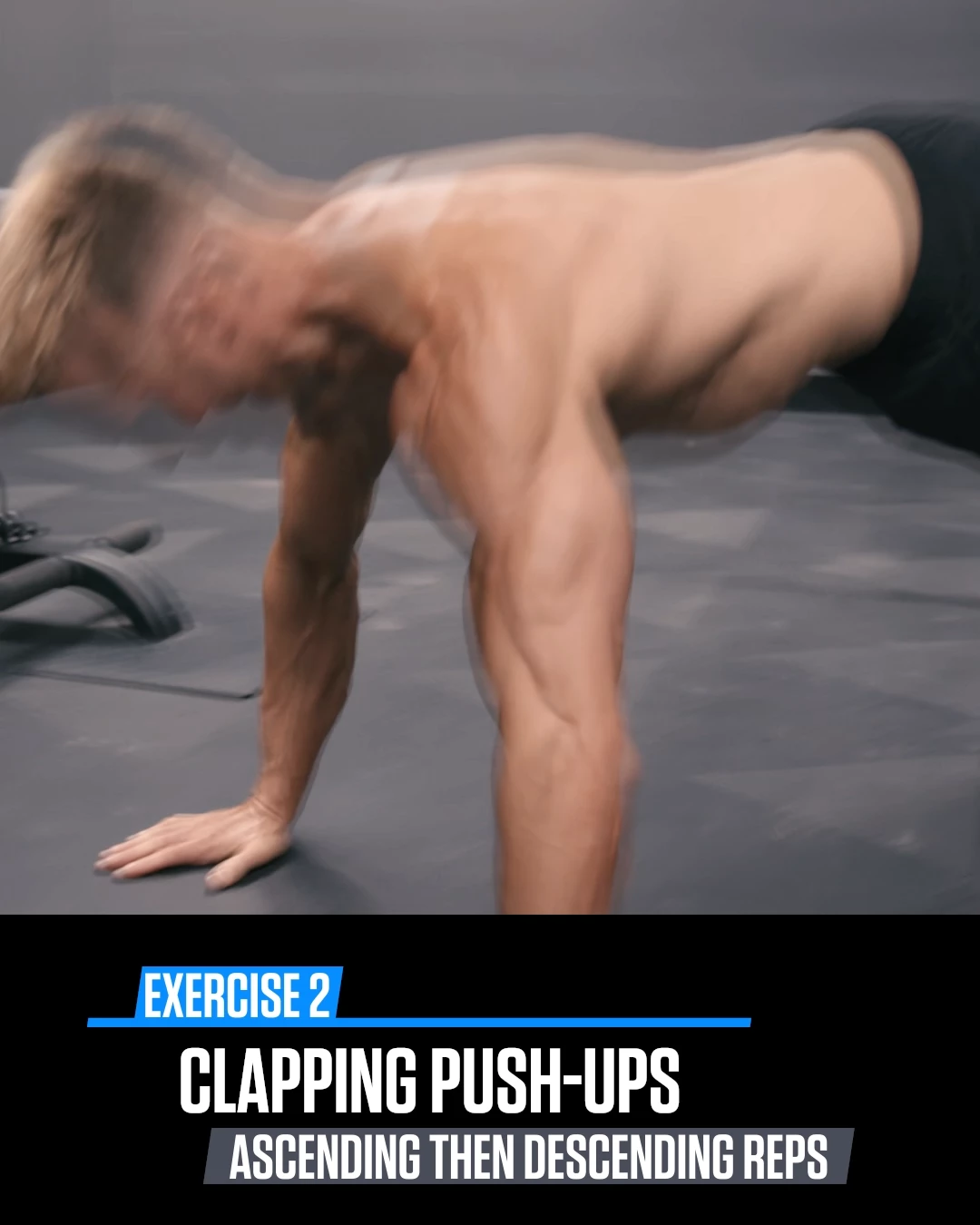

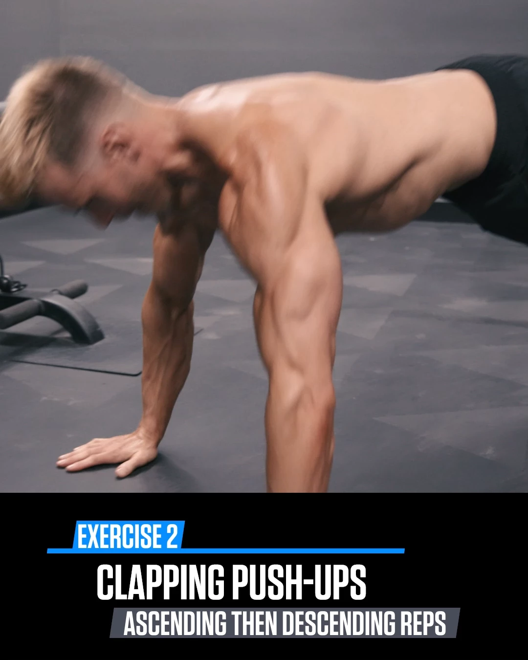

I just noticed when encoding a 23.976 video in Adobe Media Encoder using H.265 HEVC (Match Source High Bitrate preset), the resulting video has extra blended frames. If I export the encode using H.264 AVC (Match Source High Bitrate preset) it looks normal. Here's the comparison:
Above is a screenshot of the the H.265 version that Media Encoed messed up.
And above is a screenshot of the H.264 version that encoded properly.

In Adobe media encoder, you can choose if you're going to use frame blending or frame sampling. h.264 has frame sampling as default, and HEVC has frame blending as default.
