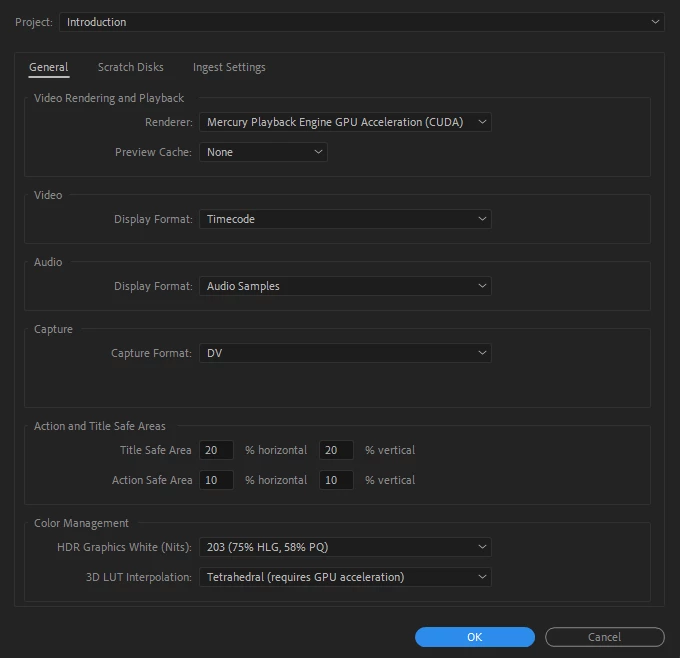

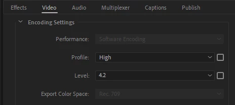

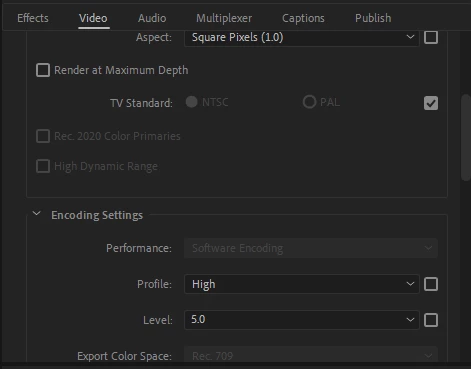

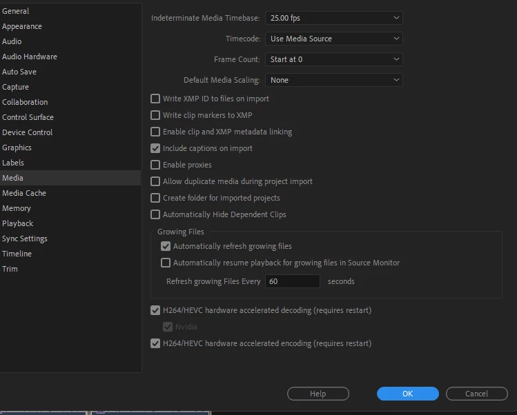

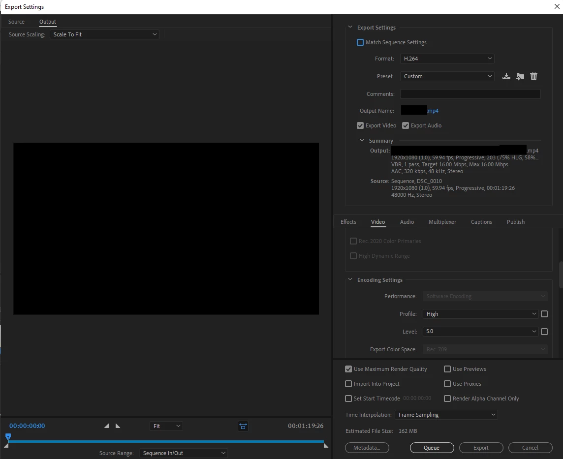

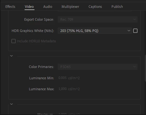

Not all export settings support Hardware Encoding.
Please post screenshots showing all export settings.
November 21, 2022
Hi, are these enough ?
