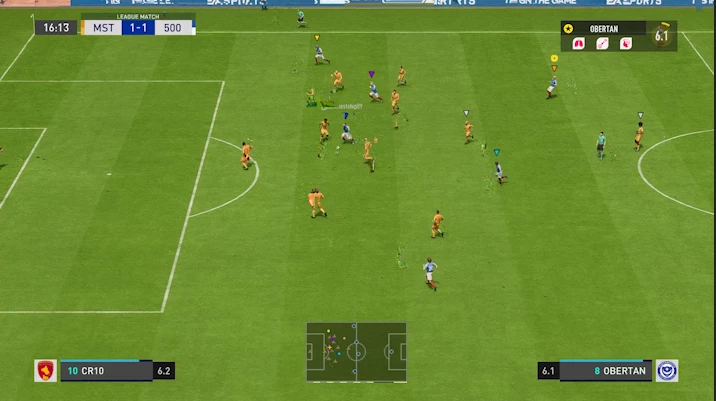

im having issue with the source and program tiles. when i am rewatching the videos i am editing the video seems to be mashing together and having a pixelated and laggy experience.
I am using a ryzen 5 3600 6 core CPU with 16gb of ram running at 3200mhz along with a nvidia 2060 super with up to date graphics drivers.
i have attached a photo of the issue. which shows what my issue is.

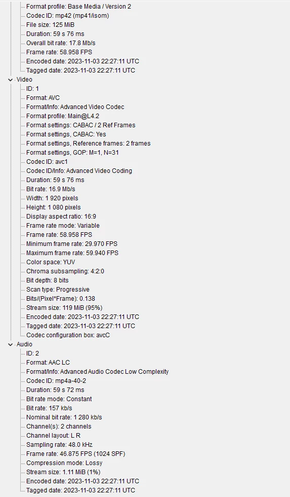

Is there mashing in that small picture above? I'm not sure what that is, it looks like a football field? And I'm not sure even the pixelation from the picture. With the timeline panel selected, check the Sequence settings from the Sequence menu up top. It should be full HD 1920x1080, just like your clip.
Also, your clip is variable frame rate (VFR) which is not good for editing and can cause some problems. I'm not sure if it is what you are seeing. Use Shutter Encoder to convert the files (before editing) to constant frame rate. Maybe try ProRes LT or even ProRes PROXY format within Shutter Encoder for easy to edit formats with 'better' files size.

sorry for the delay had issues getting into my account, here is the info on a clip that is doing this

Send us some info on the video clip you are referring to?
You can use the free MediaInfo program to get info on your clips. Get the program from the link below and using the 'Tree' view post a screenshot of your clip info: https://mediaarea.net/en/MediaInfo/Download
