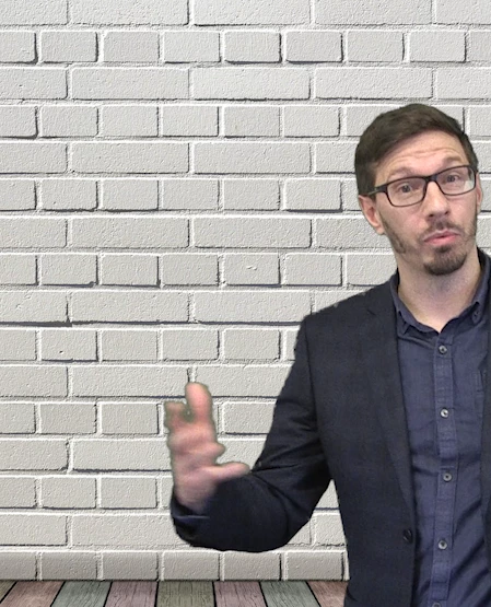

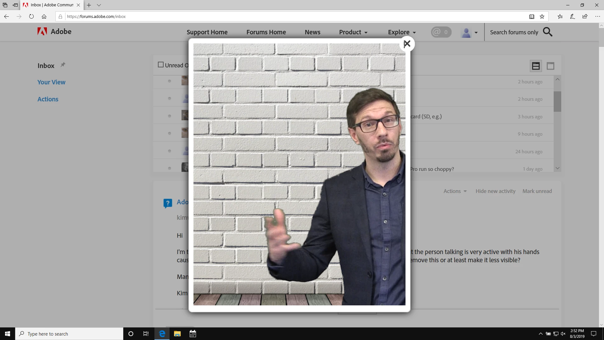

Hi
I'm tried to edit some footage, shot against green screen.  Green screen removed fine but the person talking is very active with his hands causing and area of green to be associated with the motion.  Can anyone advise how I remove this or at least make it less visible?

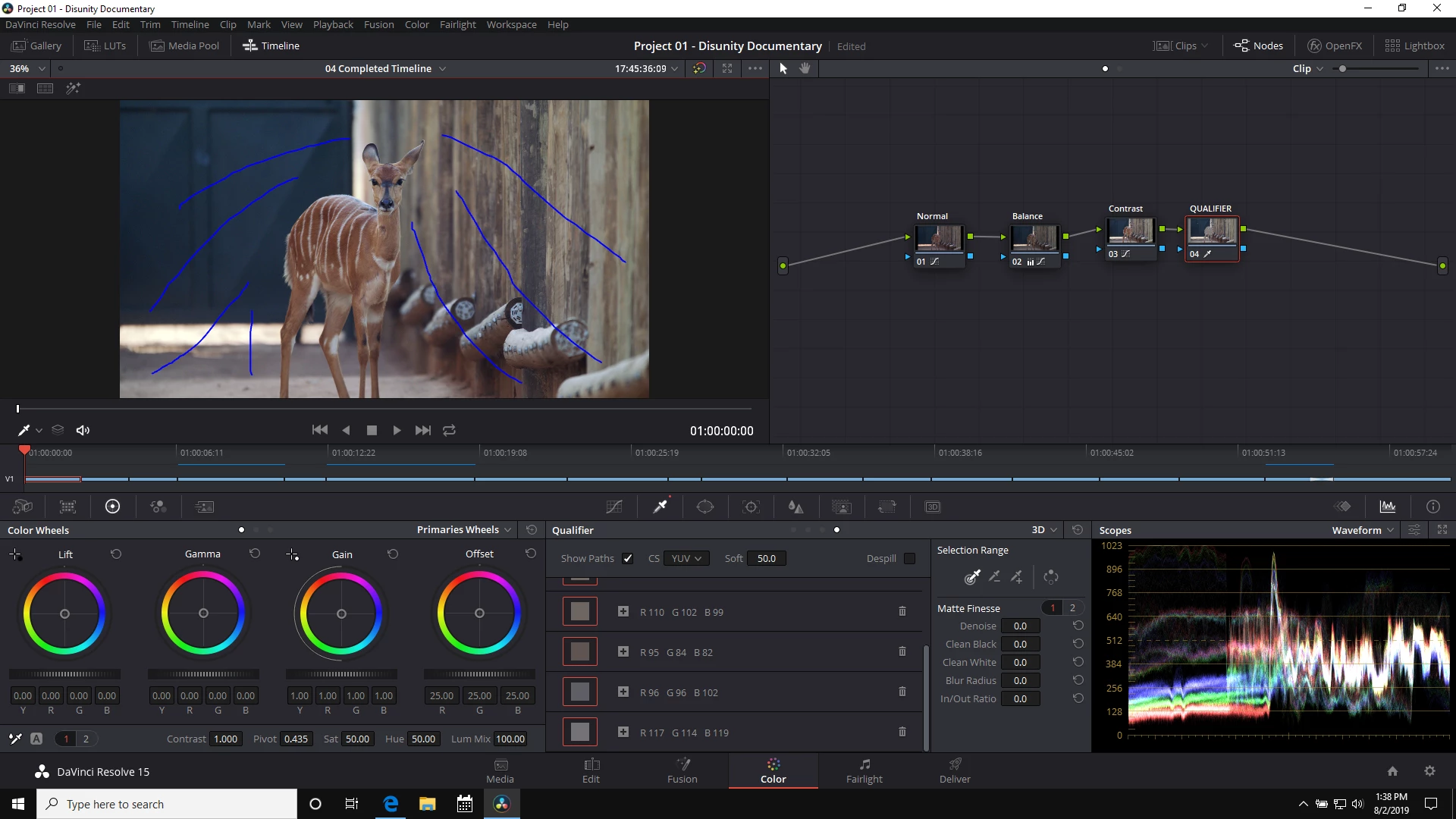

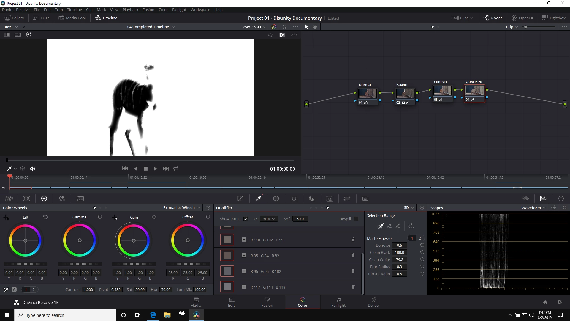

August 2, 2019
I disagree, but I'm using resolve now instead of CS6. Even without going to fusion I could fix that.  24fps is normal so it's not blur, it's the 'key' ( adjustments via simple )
example....
animal with all colors ( no green screen ) selected by a 3d qualifier tool.. ( range of color = each blue lines )…
mask revealed = next image
basic cleaning of key = image 3...
If I can do THAT ( using all the colors shared by nice animal and his surrounding... imagine how clean it would be with your green screen !!!
blur has nothing to do with it...

Don't think you will be able to fix that: too much motion blur.
I would settle for a greenish background.

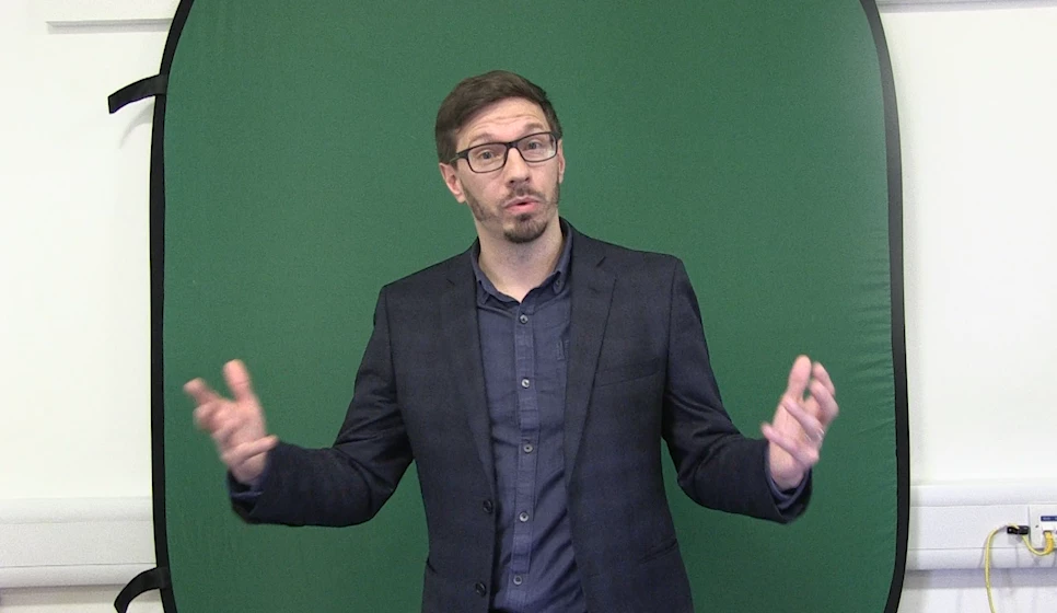

Please provide a still frame grab showing the issue, perhaps with and without keying applied. Also, do the Sequence Settings match the source video? If you are inadvertently changing the frame rate or something, that can make things worse.

The pics are very helpful. Not all green screens are created equal - yours looks very dark, and a brighter more saturated green is going to work better. I actually use a bright green sheet from a fabric store. Almost a neon green. I also do have a pop-up like yours and it just doesn't work as well. Chroma Keying works off the color value of the pixels and the dark green just doesn't given enough saturation value to the pixels to set them apart from the foreground subject.
If you look at talent's right shoulder and arm, it's not really a good key, has chunks missing. Just more apparent on the hand due to motion.
What are the camera recording settings settings, for instance 1080i, 1080p30, 1080p60? And recording to what format, like AVCHD or?? You will get best results recording to a 4:2:2 format versus 4:2:0 which records less color information in the signal. Some cameras will offer both recording modes. What model are you using? You want to at least use the highest quality, highest bitrate record mode you can to give you an edge with the keying.
One will usually get a better keying result recording progressive (1080p etc) versus interlaced (1080i).
Of course, lighting is the most important factor in getting a great key result.
I'd definitely try a different background for starters though. The pop-up is convenient, but that shade of green is not helping you one bit.
