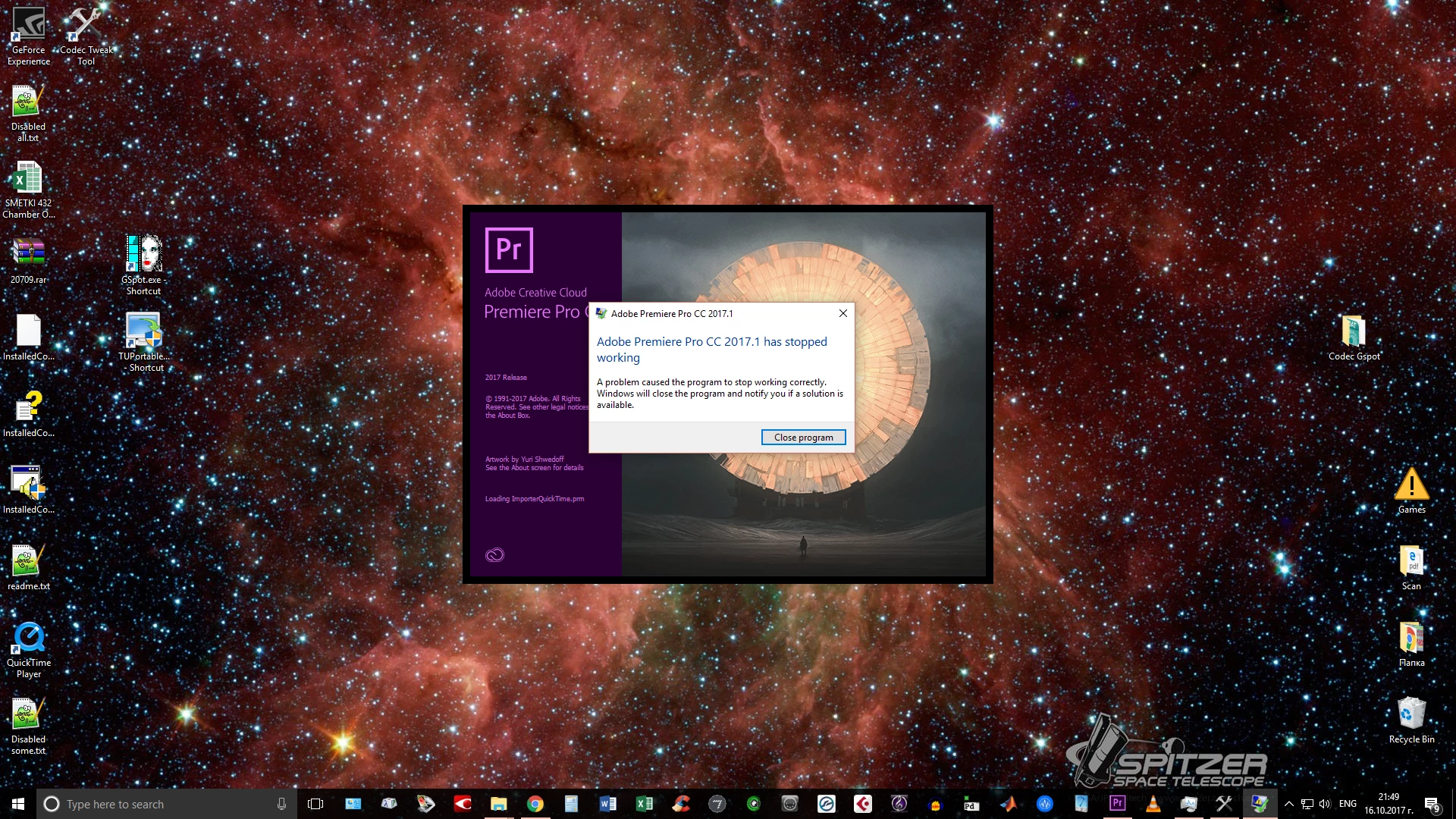

I recently tried to open my Adobe Premiere or any other video editing programme by Adobe and it does not start. Instead, I only get the error message "Adobe Premiere Pro could not find any capable video play modules. Please update your video drivers and start again."
I have a Desktop PC Win10 Gigabyte motherboard with Intel i7 7700K and Gigabyte Nvidia 1050Ti Video adapter. I have updated the NVidia drivers - does not help. I tried disabling the internal CPU graphics chip but that does not help either. I uninstalled K-Lite mega codec pack, ffdshow, Divex codecs - nothing changed. I used G-spot to unregister codecs, I used InstalledCodec.exe to disable codecs - nothing seems to work the problem out.

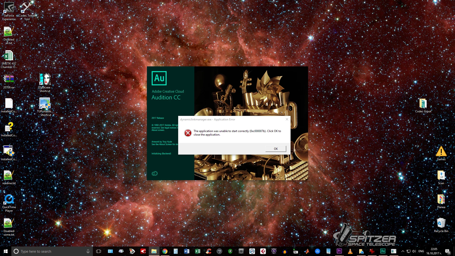

Apart from that Adobe Audition gives me an error (0xc000007b) The application was unable to start correctly."
I reinstalled all the C++ redistributable packages from 2012 to 2017 - that didn't help either.
