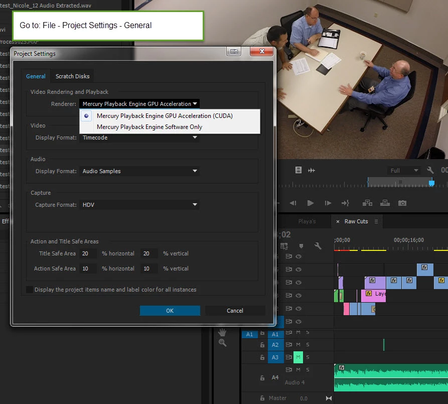

    igdrcl64.dll is the intel graphcis accelerator.  You might have an issue with OpenCL.  What happens if you switch MPE to Software mode?

    Goto file, project settings, general.  See if MPE is running in CUDA or OpenCL, and if so, switch it to Software.
