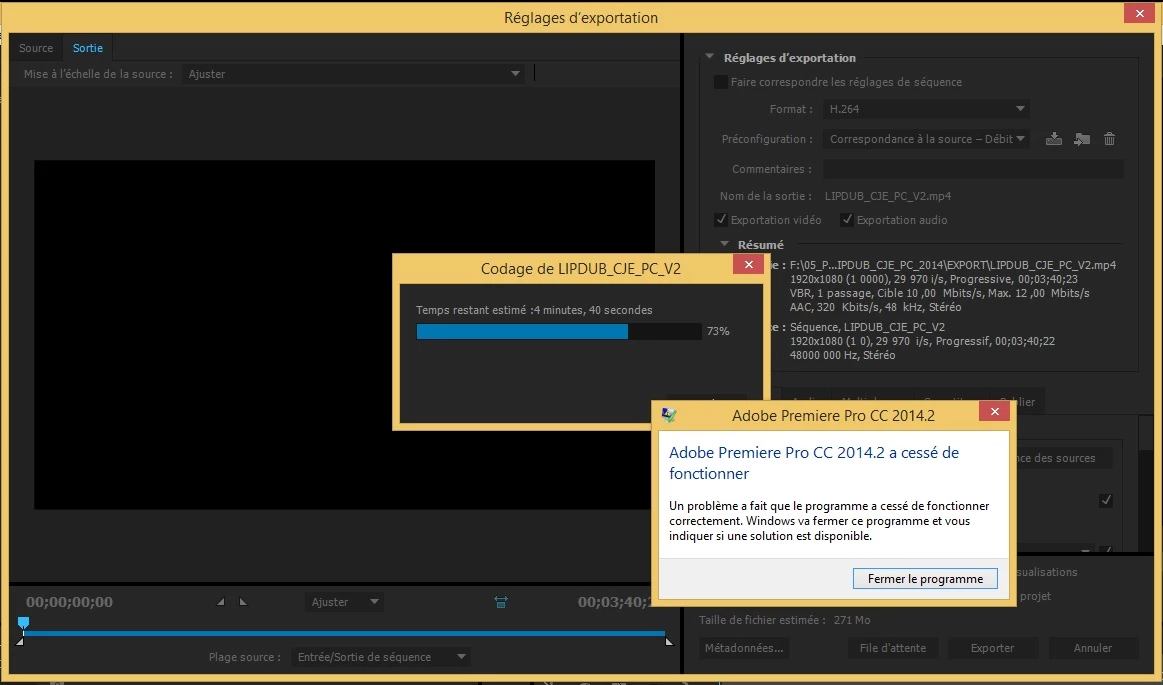

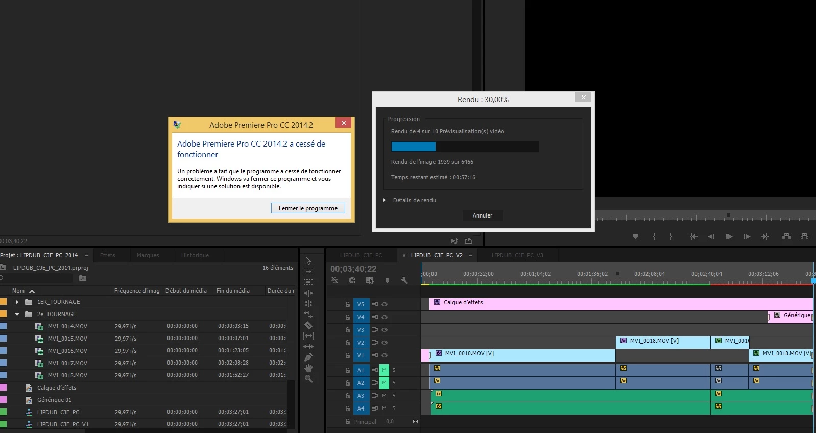

Dec 20, 2014 2:59 AM UTC
Hi there,
I had some issues recently : When I export a timeline, at a certain point Adobe Premiere CC 2014 crashes.
Afterwards I've tried to render the timeline before exporting the clip and turns out that it crash at the same point.
I don't know why some fades between clips and some blur would make Adobe Premiere CC crash.
I've checked if this is the program itself or the effect. Turns out it's the effect that make it crash all the time! Why?
