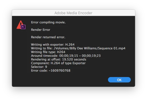

Hello! I've been trying to render this video for nearly 2 months now, but all my attempts have failed. It always crashes and gives me this error code in Adobe Media Encoder;
Error code: -1609629695
(Image taken from another thread on the forums, but it is exactly the same error but in Swedish as it is my set language)
The video I am trying to render is not a common video to say the least. It is 11 hours and 59 minutes long, and has been sped up by 2% to make it that long (so that YouTube allows it for upload). Videos shorter than this or long videos that are not sped up like this usually render without any issues.

For what it's worth, I struggled with error 1609629695 for many hours. I finally discovered that the export fails if I select "Use Maximum Render Quality" but it's OK if I de-select it.
R Neil Haugen
July 1, 2018
"Max Render Q" and "Max Bit Depth" are neither needed nor useful for probably the majority of work being exported, and both can at times cause odd artifacts or errors, so I leave them both off as a matter of course.
