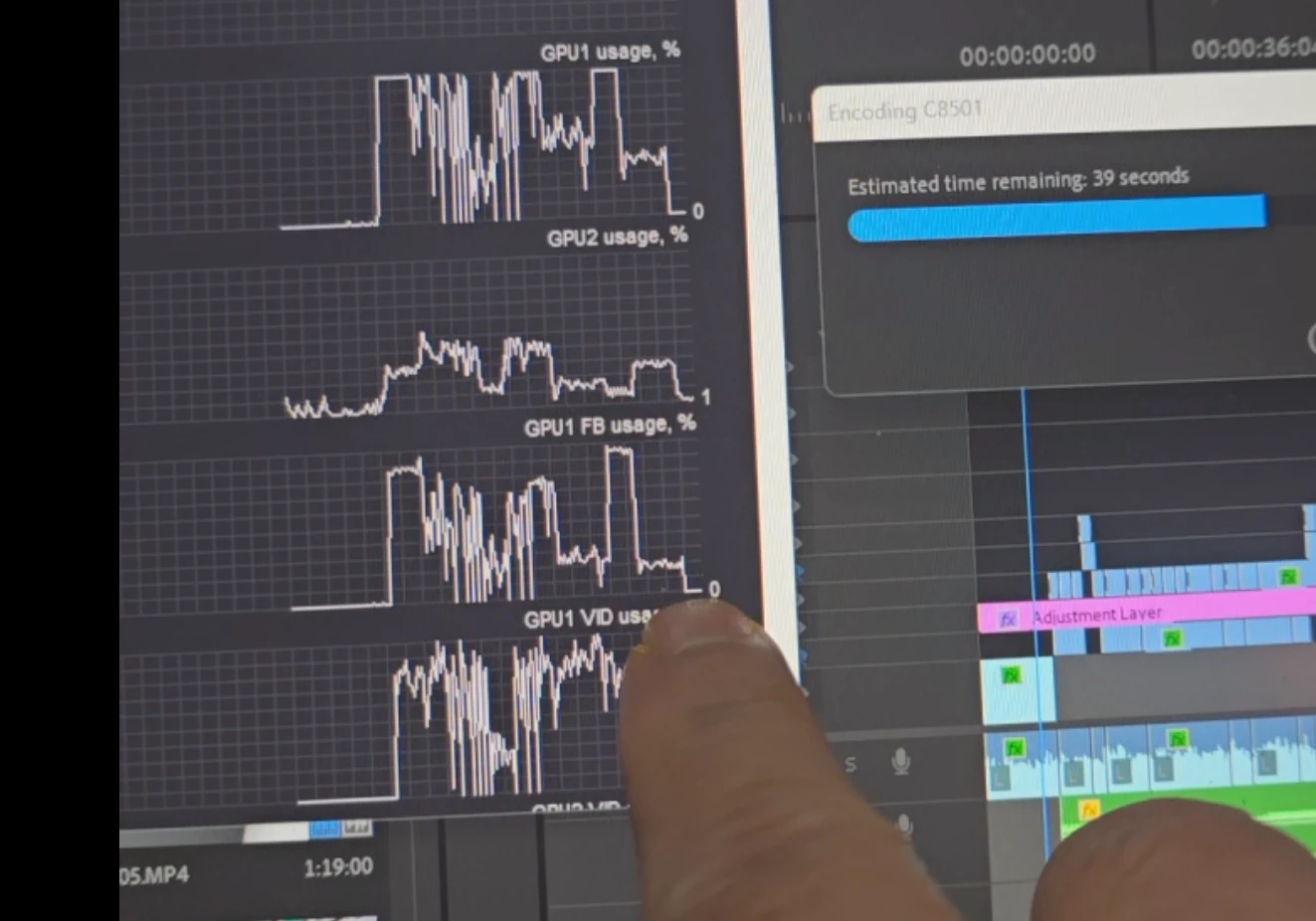

My problem is that Adobe Premiere Pro stops using the dedicated graphics card when the rendering process reaches 80%, as you can see in the attached picture. In the picture, I show the GPU load suddenly dropping to 0% when the rendering process reaches 80%. If I stop the rendering, the playback suddenly becomes a black screen but still can play.
