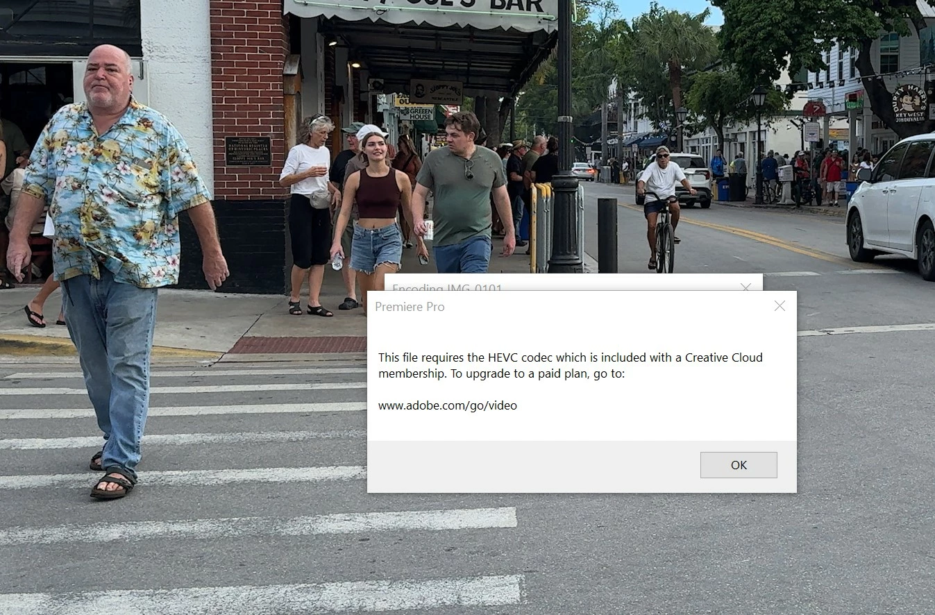

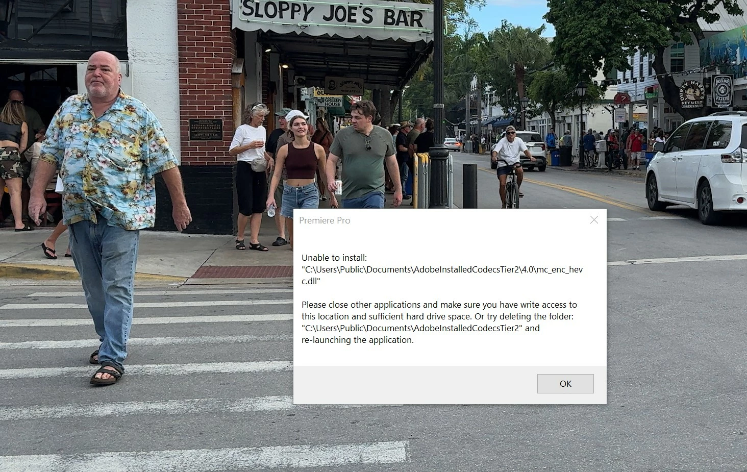

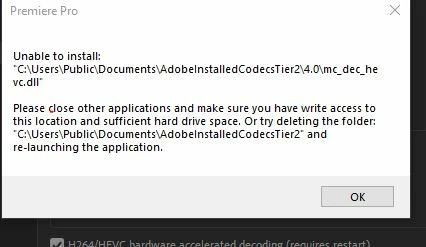

AdobeInstalledCodecsTier2 has no codecs. Videos dont work.
I dont have codecs in the 'AdobeInstalledCodecsTier2' folder. They should be populating after rebooting. Tried many things. Tried many suggested solutions. This is a terrible glitch - as adobe should be compatible with go pro footage. I have seen alot of problems similar to this this - but difficult to get a working solution - and that means i cant complete my video. Ive uploaded the error message. When i try to render a movie. It takes ages - and the video doesnt work - only the sound works. But I can see the footage when im editing.
