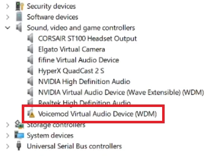

    I would check why you have an error with the Voicemod Virtual Audio Device (WDM) and try to fix that since problems with this can cause Premiere to behave like you see/have, iow stop playback soon after it has started.
    At the same time i would in Premiere go to Edit > Audio Hardware and make sure or verify that Voicemod Virtual Audio Device (WDM) is not listed there. And, set the Default Input to None while you are there. If it is listed, fix it in Windows.

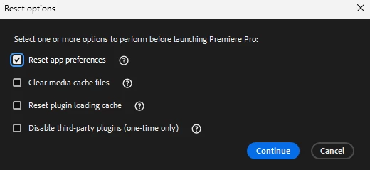

    Still issues? Deleting Premiere´s preferences by holding down the Shift-key while launching Premiere and check the box for “Reset app preferences” do work for some issues. But i think your case is more related to the Voicemod Virtual Audio Device (WDM), so fixing that is what i would do first.

    KShinabery212
    Sept. 21, 2026 4:10 PM UTC
    This was actually taken care of when I got stuck in the ChatGPT loop.
    So that was not the issue 😓
    I am trying to find the ChatGPT conversation I had about fixing it.
