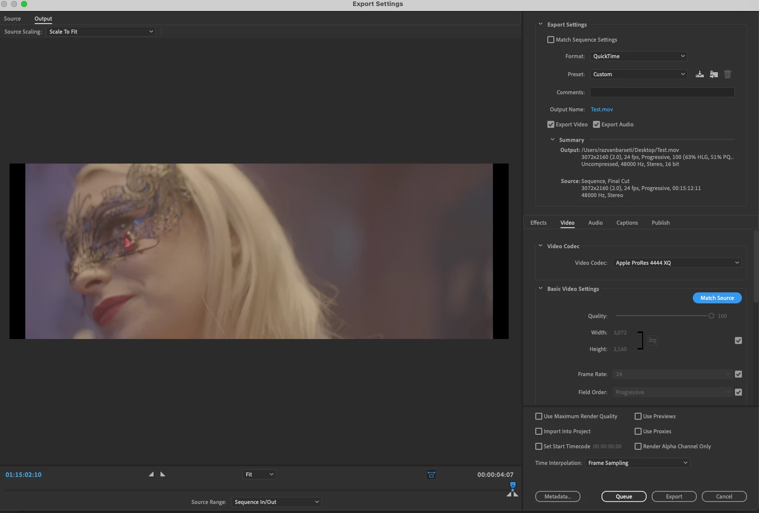

I've edited a short film that was shot with Arri. From what I saw, the footage was shot anamorphic. The problem is that when I export, the image has side bars and seems a tiny bit smaller. Also, when the footage was imported in the project it does the same thing: it has side bars when it is shown in the window preview. I don't understand why it does that.
To make things easier to understand, I've uploaded screenshots: one is the original footage, one is the video exported and one is with my Sequence Settings.

Yes, the original footage is mxf. When importing in Adobe, for some reason, it shows them with the side bars in the preview windows. I exported as Apple prores, that's how it becomes mov. I tried to export a H264, but it still has side bars.
Like Ann suggested and some other people, I will probably scale it a bit and then export.

Sorry, I've noticed the first picture is too small, so I've uploaded here again.

At first glans the exported file has a different PAR then the original, guessing that is why it has bars.
Please post screenshot export settings.
Please upload short testclip.
February 20, 2022
Hello Ann,
Thank you for replying! I've uploaded what you requested. Below there is also a link to a test video. Thank you!
