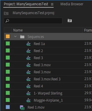

I just created a project and made 10 new sequences each with a clip and they all work fine. I closed each one to create a new sequence, or you could select each clip and right-click and 'new sequence from clip' so, not sure. I played each one, then I loaded all of them and played each one and all was well

It's not normal of course. Did you try with a new project? Create a new Project and then add a few clips and add 3 sequences and see what happens. You can drop a clip on an empty timeline to create the sequence. Close the sequence and do the other two...

I tested what you suggested. See the following: 1) I created a new project 2) Create a new sequence 3) I created about 5 sequences, but without any content 4) When I created the sixth, it started with the error So once again I have all interface with lag.
