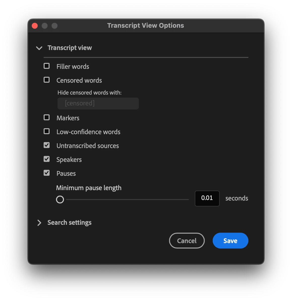

    I checked both version 26.3.2 and the latest Beta (26.5), and in both cases you can still set the Pause Length to 0.01 seconds.
    It's also worth checking your Premiere Pro and system language and locale settings, since this could be tied to how decimal values are parsed under the Portuguese locale.
    I'd also suggest resetting your Preferences. If the problem persists, please share a screenshot.
