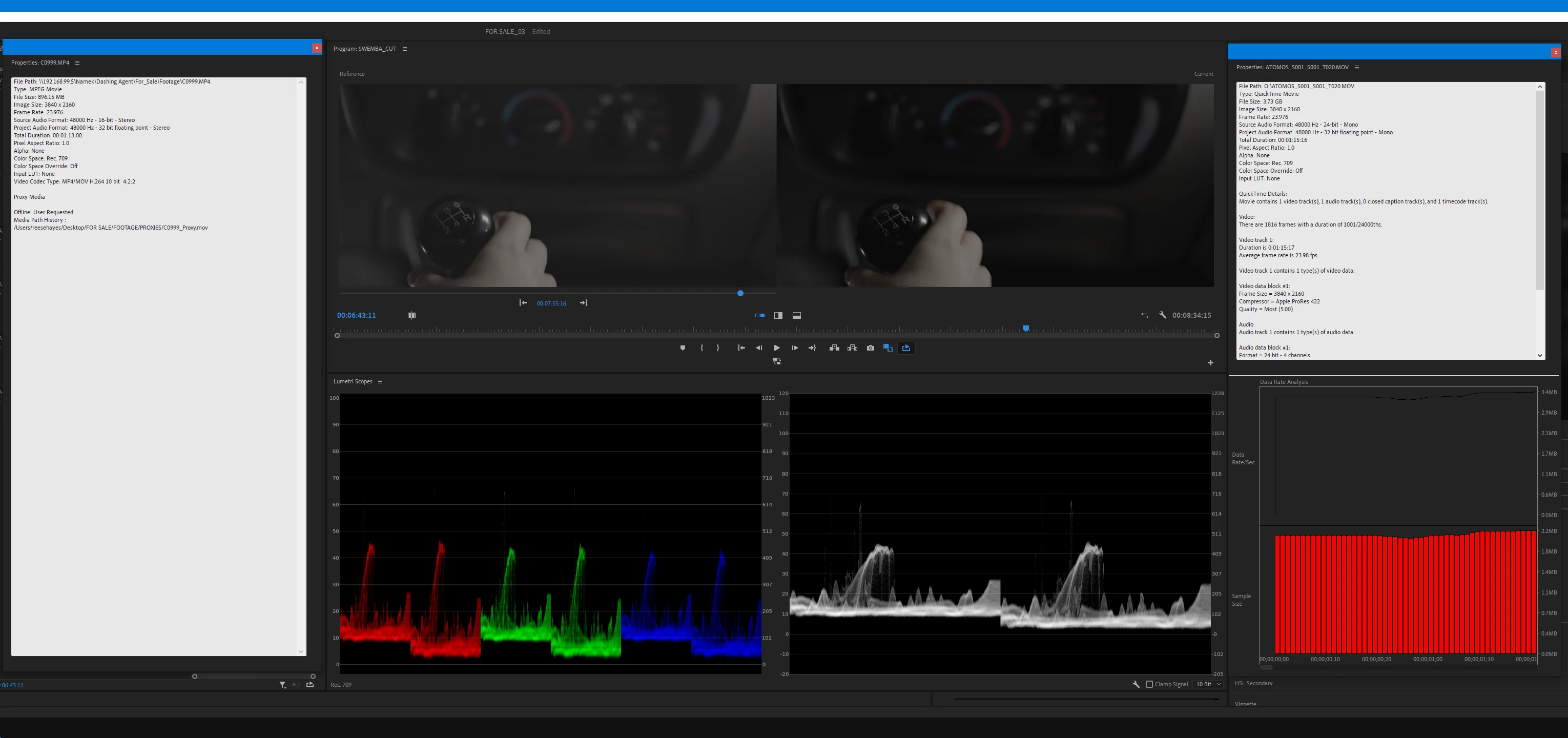

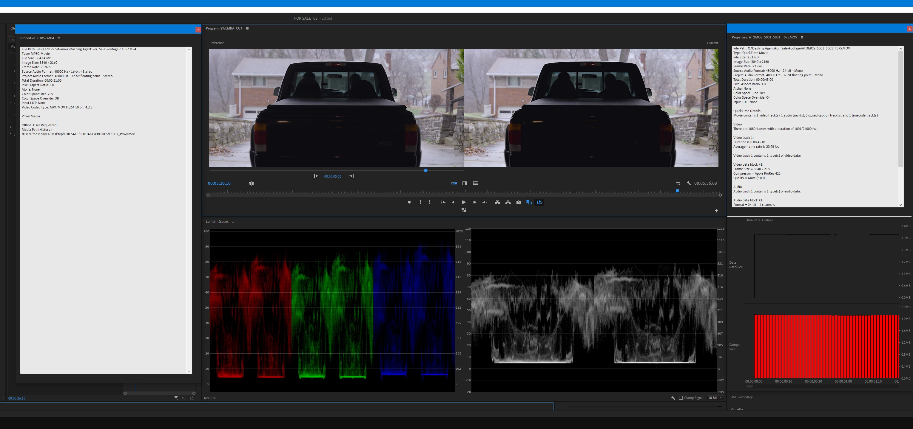

Trying to diagnose the issue here. Right now I am just not using the Atomos for anything more than a glorified monitor. This was shot on a Sony A7siii in XAVC S S-Log3 internally and recorded via HDMI to the Atomos Shogun Flame with no LUT applied to ProRes422.
I also tested this previously on my FS7 with both HDMI and SDI out and the Atomos footage underperformed the internally recorded XAVC-I. I figured it might just be that camera, but now that is happening with the A7siii i'm starting to think it's my NLE.
The first image is straight S-Log3 from both sources. The second image is with a LUT applied. As you can see the image is dark and there is much less detail in the blacks.
Any ideas?

Neil, I really would appreciate you looking at this! That bottom shot is the most extreme from the film, but was shot at native ISO at 2.8, just couldn't throw much more light on it without it looking "sourcey". It's a good example showing how the blacks are crushed on the ATOMOS LOG though.

First, I'm wondering about the exposure setup. That line across the bottom ... huh. Underexposed, perhaps?
